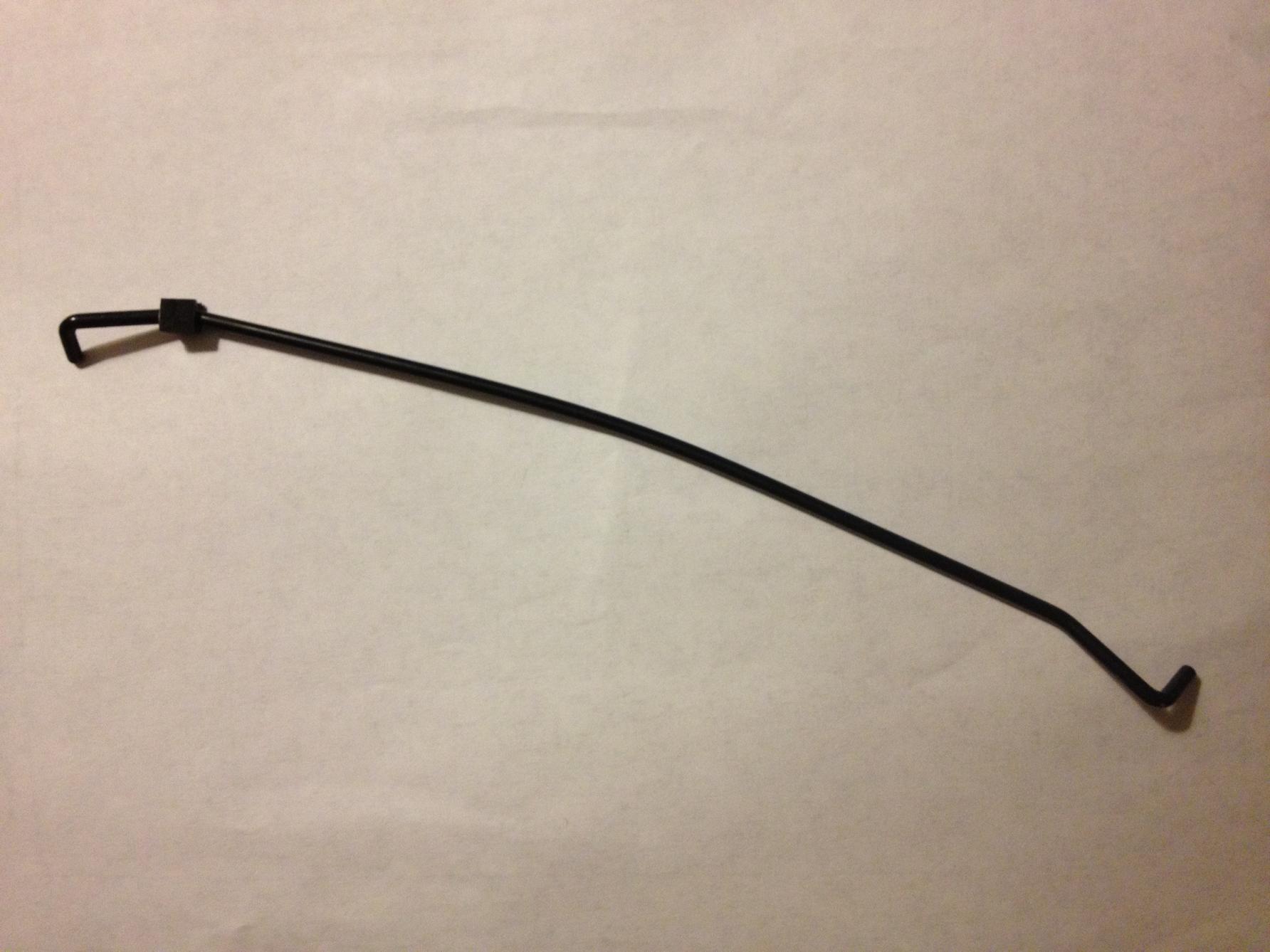

I popped my hood tonight to check out a few things and I stuck my hand under the grill to lift the hood and the release lever was just moving back and forth without allowing me to open the hood. I noticed there was a rod that was just hanging so I crawled under the car and popped the latch by hand.
Once I got the hood up I saw this rod that was just hanging and it was obvious it was broke. It's the rod that connects the release lever to the latch. I've included a picture of the rod that I took off. Now my release lever is useless and I have to open the hood by sticking my hand through the grill. Does anyone know what this part is actually called and where I can get a replacement? image.jpg

#13 is the part you're looking for in the diagram.
Did you see if you could reinstall the bar? The steel rod itself doesn't look broken....
The rod is okay, what you need are the plastic end clips that secure the rod at both ends. It should be part number 16 as shown in the diagram in the link that jimithing provided in his post. Did you look at under your hood to see if the plastic end clips are still there or if the broken remains of the clips are there?

The rod itself is ok. The plastic ends broke into pieces all over the driveway. I figured I would have to buy the rod and clips together but being able to buy the clips by themselves is great!

Last month mine broke as well on one side, I just applied some jb weld at the end of the rod since the locking plastic clip/washer was busted and it is holding up just fine
This happened to me too. I've just been sticking my fingers under the hood to unlatch it myself. I lost my rod too. So do I need the rod and the clip? Is that parts 15 and 16? It's hard to tell from the diagram since none of them look like the rod...
