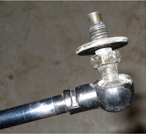

Here I have a hood strut removed & showing how the mounting ball / nipple is built-in.

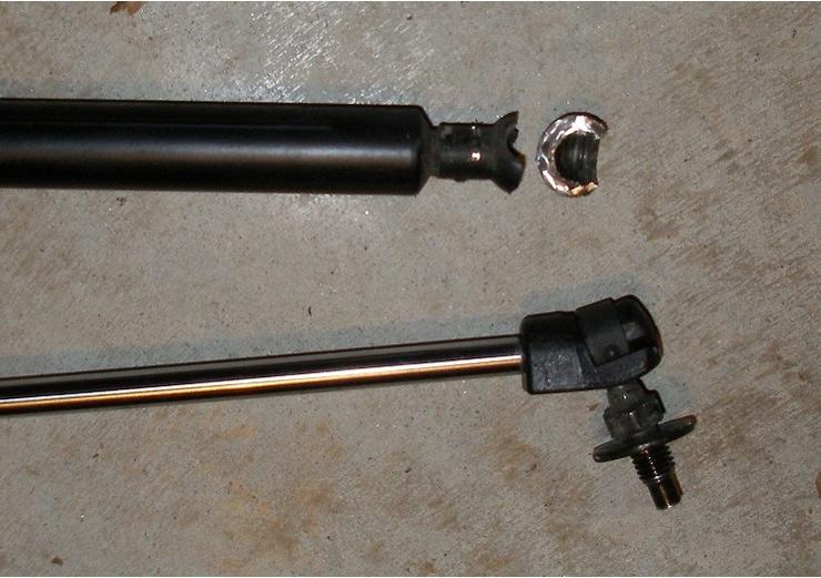

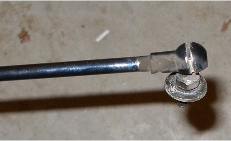

Here you can see I've used a dremel to split the end to re-use the mounting ball / nipple with the new gas strut.
Then after receiving the new gas strut, I found they included nice shiny new mounting ball / nipples (that's kinda fun to say) in the box. Oh well, I'll hold on to them for a rainy day.

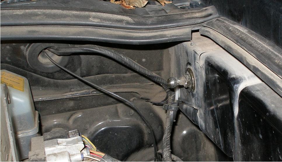

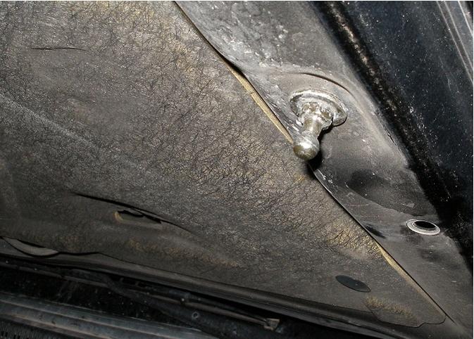

These are the old ones installed since I went through all the trouble...
