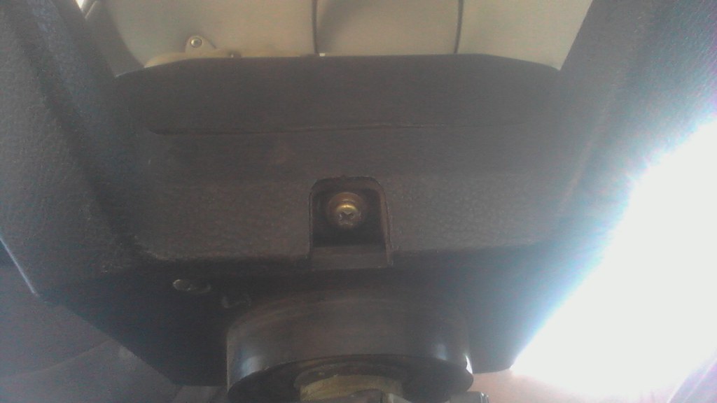

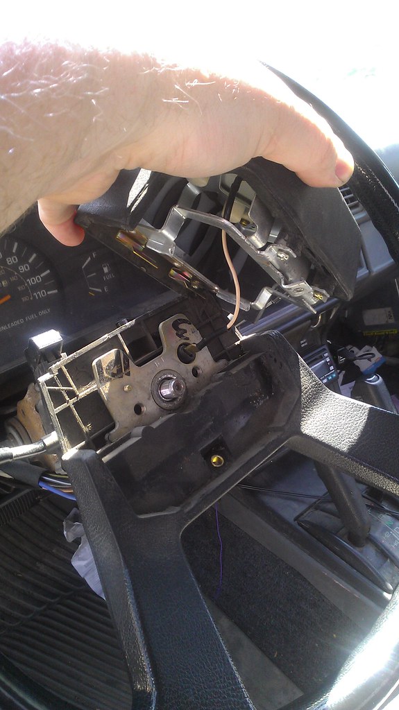

One phillips head, under the steering wheel:

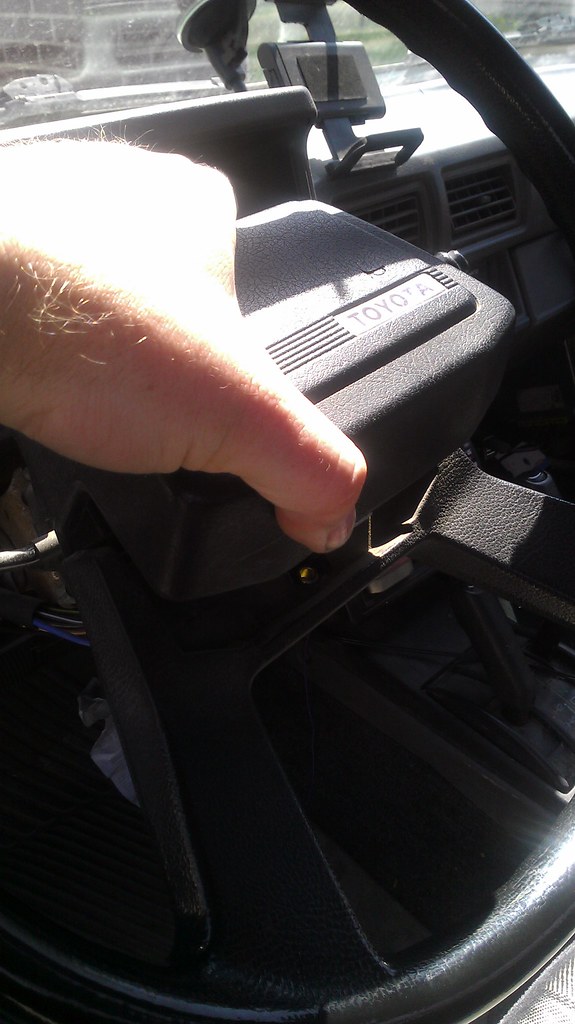

Pull out and lift off the center assembly. Be careful, there's a wire on a spade connection underneath.

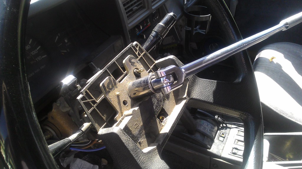

19mm bolt - you'll probably want a breaker bar here. Once that's off, pull the wheel. If you choose not to use a steering wheel puller, leave that nut on after you break it loose, because otherwise you will knock the stuffin' out of yourself when the steering wheel finally breaks free and clobbers you in the sternum. You Have Been Warned.

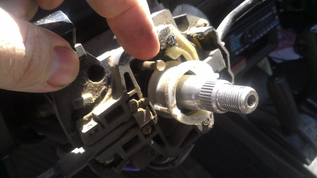

See that little spring loaded plunger? Clean the corrosion off of that. And blow the dust out of your column while you're at it, you filthy pig.

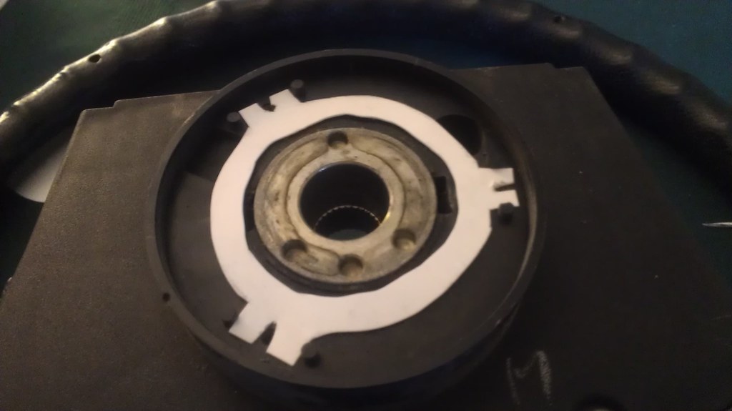

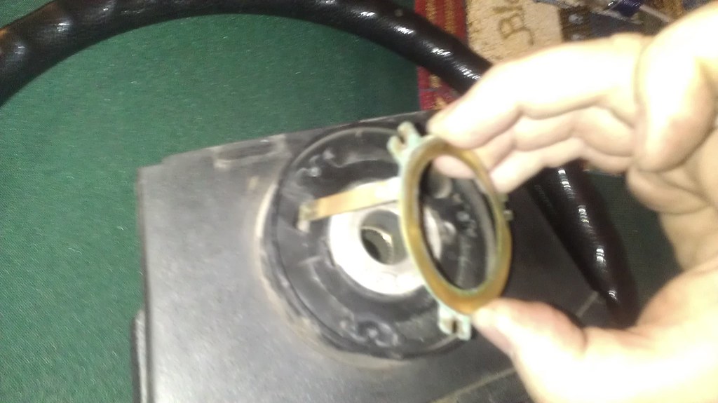

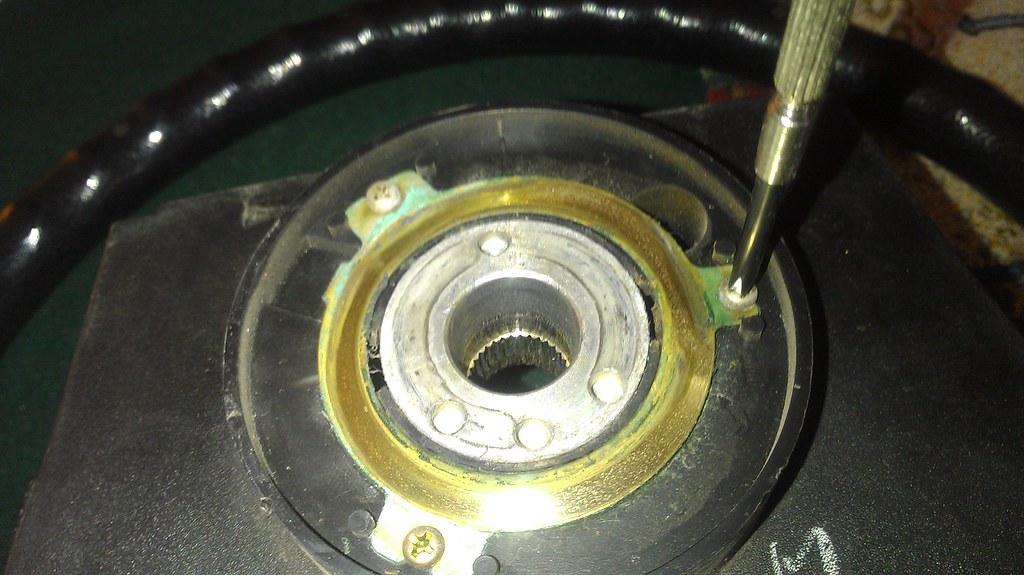

3 small phillips head screws hold this copper ring to the backside of the steering wheel.
Note the corrosion and the untracked areas where that little plunger wasn't making contact.
Remember that spade connector? You just found it.

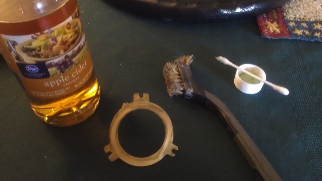

Much cleaner...
If I'd had some polishing compound or really fine grit sandpaper, I would have used it, and gotten that ring even cleaner.

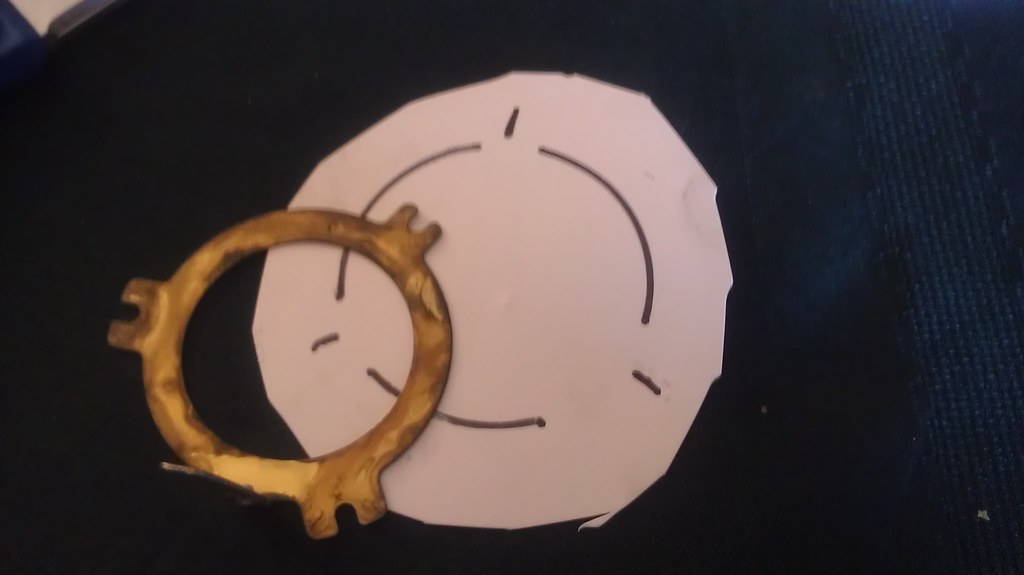

Make a shim for the backside of that ring out of whatever. I used an empty margarine tub.

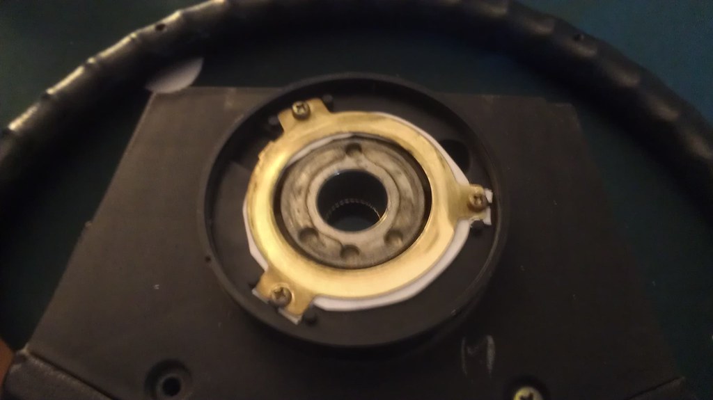

Put it all back together, and enjoy your louder horn that works no matter what position the steering wheel is at.

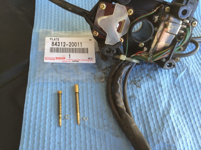

86 Pickup Solution
For my 1986 Toyota Pickup I choose to remove the turn signal stalk totally and replace with a new genuine Toyota plunger. Four screws and plunger comes off, once you unplug the two connectors at the bottom of the column. Unsnap the ring holding the plunger in (seen below) and replace. Notice the difference between the used one (left) and new one (right). Threw some dialectric grease on it for good measure. My ring on the back of the steering wheel looked new, even with 228,000 miles so I did nothing with it. If interested in buying the official Toyota part the number is 84312-20011
weird , i looked this part number up and trd parts says it doesnt exist
