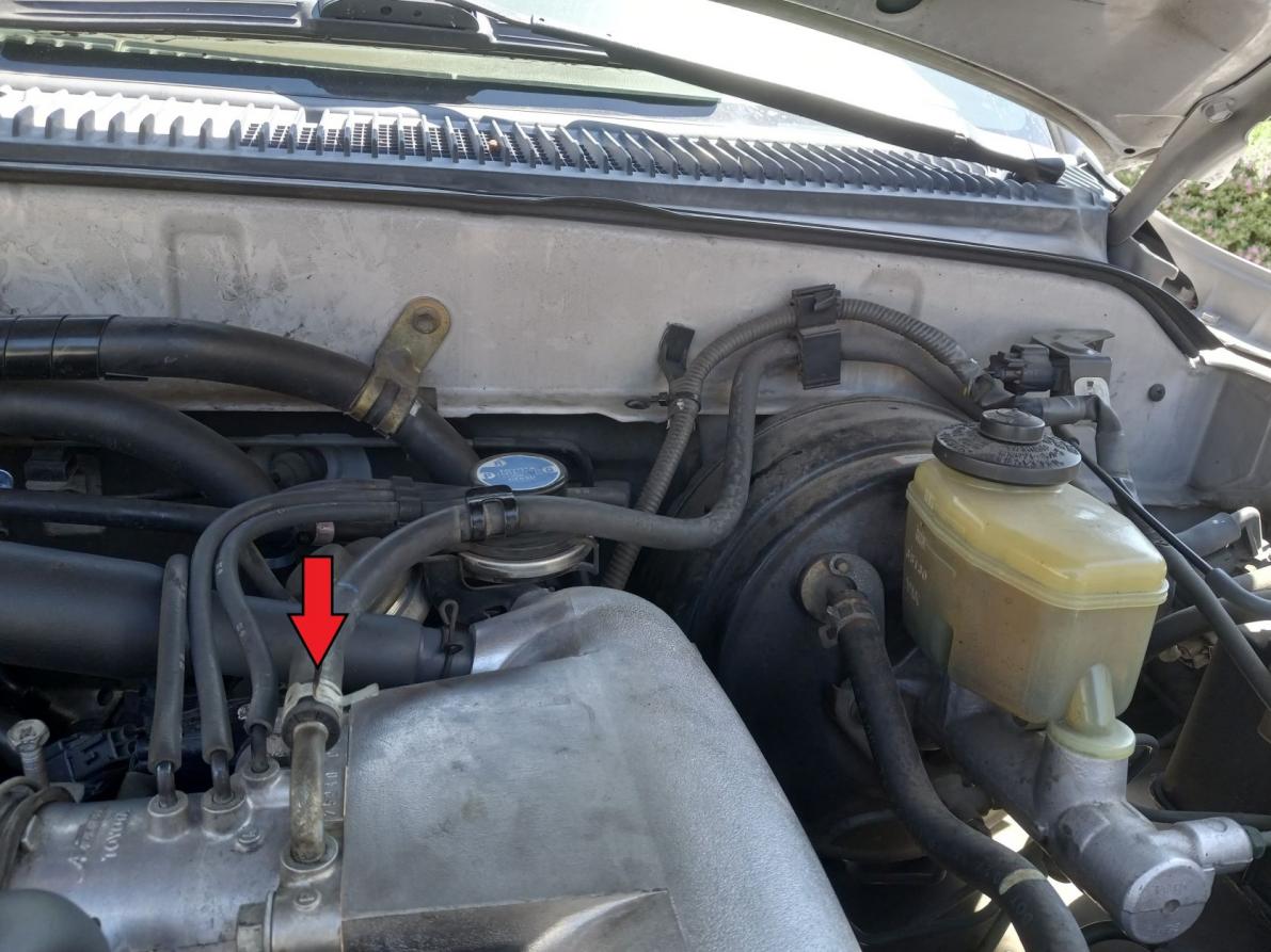

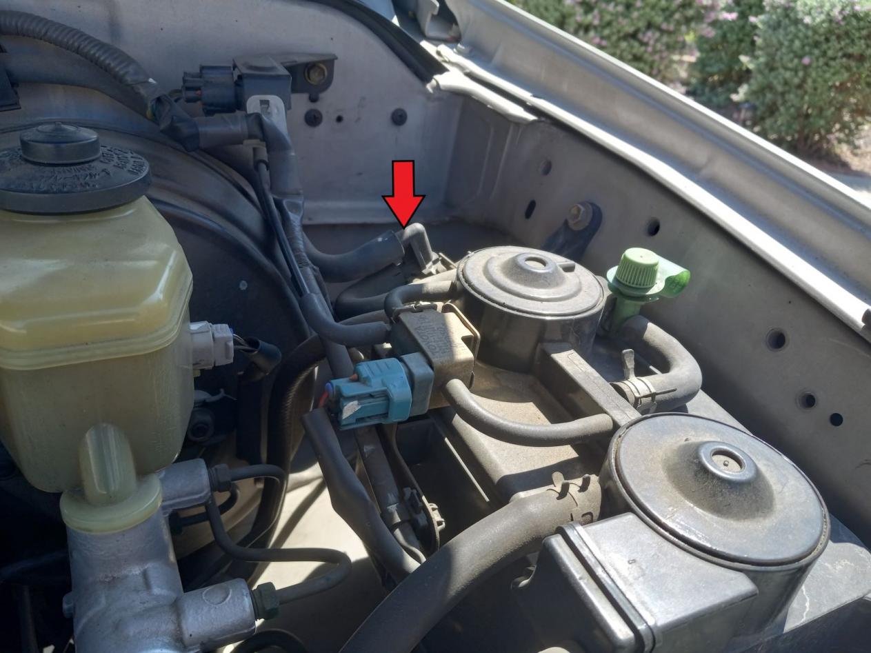

Need help finding OEM part number for a hose that connects from the throttle body to the charcoal canister. I don't know the name of the hose which is making it difficult to find the part. I know some of the parts are being discontinued. If this one is, what hose can I use as a replacement for OEM. I included some pics. I have a 2000 2.7L automatic 4runner. Thank you.
I believe it's 23827-75080.
You are right, more and more of these hoses are becoming discontinued, I'm scrambling to collect the full set for my '97.
Great thank you! The part number sent me to a nice diagram with all the hoses with their part numbers. Next question, since I'm already tinkering with the charcoal canister and being that the plastic canister is getting old and brittle after 22 years, should I just go ahead and replace it? I plan on keeping this 4runner for at least another 20 years if I can keep it running. It has 215,000 miles. Like mentioned earlier, the parts for our 3rd gens are starting to get discontinued and since I'm in the process of restoring old cracked or brittle hoses I thought I should just replace the canister while the part is still available.
I replaced that hose recently...just used some straight length from napa, a lot cheaper than a $40 formed hose. No issue getting it to snake the same path to TB.

I swapped mine this evening. It is a 5/16" hose and I needed 2 1/2 feet. Cost $6 from autozone.
Here is a photo of how it routes pretty cleanly from the charcoal canister to the TB despite not being molded:
