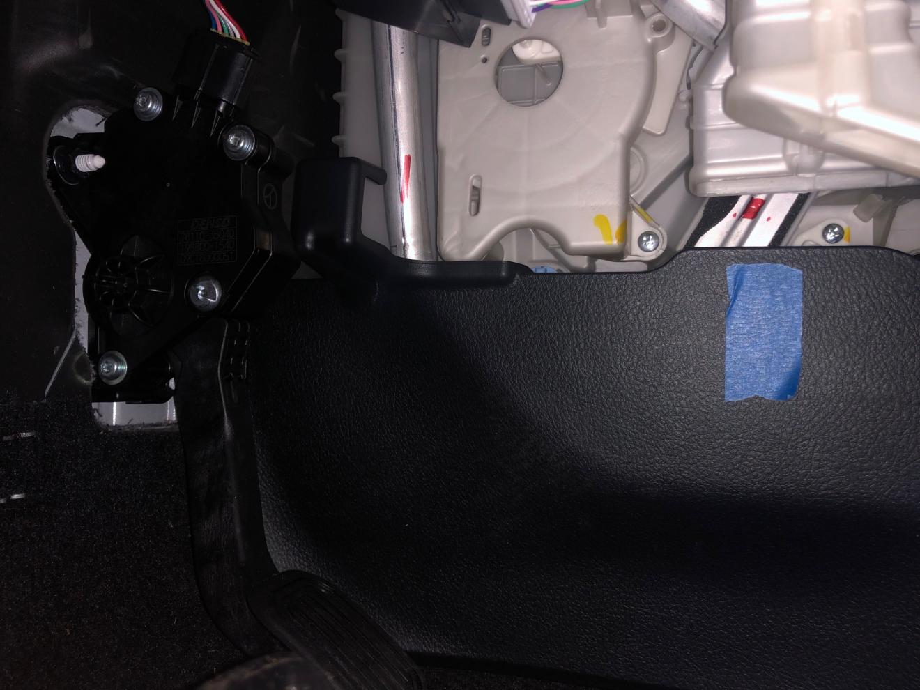

Something is weird with the temperature in the drivers footwell, and I wanted to see if any of you notice the same thing.
I notice that the temperature in the footwell is very warm, and there seems to be a light current of warm air flowing into the footwell even when the air control is set to defrost or the "face" setting (far R or far L). This causes my right foot to get warm, and I definitely did not have this issue with my other 4Runners. I felt around under the dash, and also noticed that the side of the center console is really warm (see the "blue tape" in the attached photo) this appears to be due to a lot of heat that's radiating off of the items that are marked in red. I will try to post a photo in a "reply".
Is anyone else noticing this? I'd hate to have the dash torn apart to see what's going on, but this is really bugging me.

Here's the photo...I hope

Don't know if its the same routing on your other ones, but perhaps because of the coolant pipe (with the red line) on it that runs through the area.
I know when installing a pedal commander/sprint booster, the instructions make note to avoid the area due to heat.
x2..you see the vertical tubing with the red line on it..that's part of the cooling system and runs behind that area and it gets very hot..
Regarding the pipe for the coolant circuit - yes I saw that. I would have thought that Toyota would have insulated the pipe, and my 2012 is long gone, so I don't know if this was a revision relative to the older versions.
