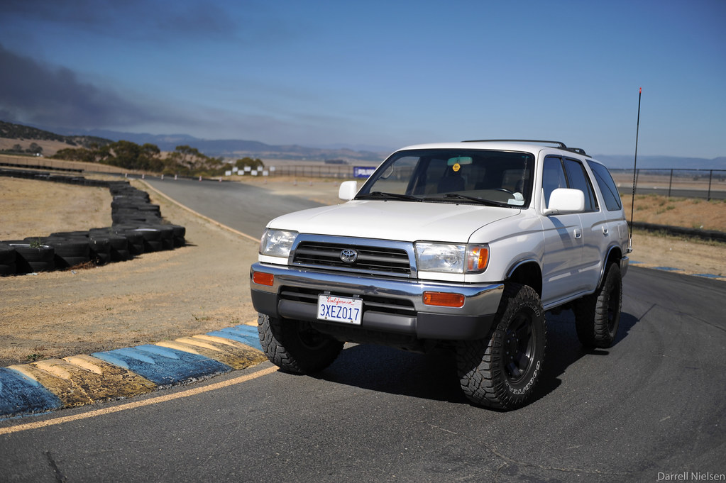

So last week I got a little track time in with my Runner and did some not-so-hot laps...
Probably set the slowest lap time for this little circuit made for high output Go Karts. I have no regrets.
