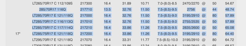

This looks to be a great build. When I was shopping around, I think I was offered this exact TRD PRO up in NH but decided to go with white and cloth interior, and therefore decided on a TRD OR. The lift looks great. However....
I think you need new rims for the tire size you chose with the Nitto Ridge. Their recommendation is a width of 7.5" at a minimum. By how your tire sits on the rim in the last photo, it looks like the rim is too narrow. TRD PRO rims are 7" wide. Check out the Nitto Spec. https://www.nittotire.com/light-truck-tires/ridge-grappler-light-truck-tire/

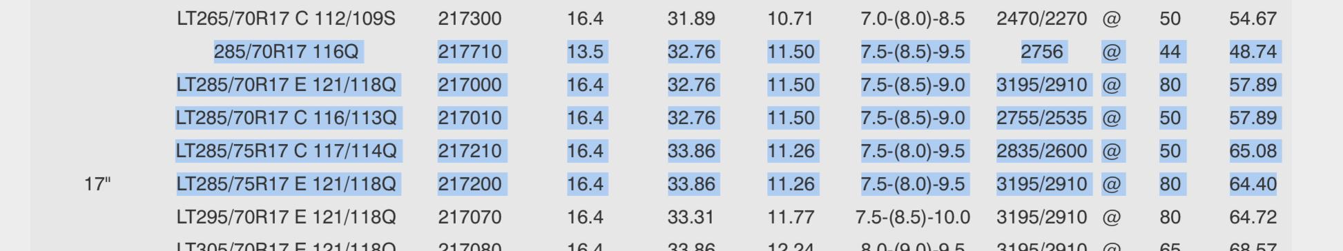

Hundreds if not thousands of people are running 285's with the 7inch Pro rims without issues. The only issue is like you mentioned the little over hang that causes it to bubble out. It isn't a huge issue and mainly is just a looks thing from what I have been told and read.
The dealership wasn't even allocated this truck and had to make calls to secure it. I don't know what the dealership did but where I bought it wasn't suppose to get it but somehow did.
Agree.
I have the same tires and wheels and air down to 15 PSI with no issues.
Been this way for 10K....no issues at all.
You're fine.
