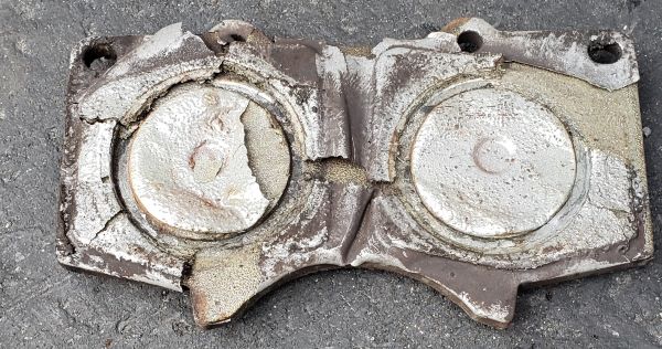

I was having an issue with my front brakes. Just about 4 months after installing new rotors and pads, I was getting a significant shaking of the steering wheel while braking. I thought - how could I need pads/rotors already!?!
On the front passenger side, the outside pad looked warped/burned (see photo). The calipers looked fine and one of the pistons had gotten so hot, that any rust had been burned off. The pistons retracted easily and the brakes worked fine. I haven't noticed any thumping noise/vibrations yet. Thoughts on what caused this?
2014 SR5 with 166K miles. Left rear brake had uneven pad wear at 145K miles. Front edge of both pads worn down. I took apart and cleaned and lubed the slide pins on the caliper and put it back on. I should take a look to see how they're wearing.
I think it is a function of climate. I live in the snow belt here in Boston, with lots of salt on the roads. Salt plus aluminum brake caliper housing plus steel piston = battery (dissimilar metals corrosion).
I've gone through so many calipers on my 4th gen that I've lost count.
Have you done your own work on the brake calipers for the 5th Gen? They are not aluminum.
