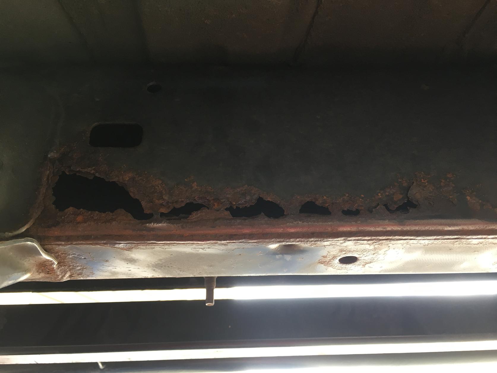

I think I really screwed the pooch on this deal. Flew to PA to look at a one owner 01 4Runner with tons of extras. Checked out the car and found some surface rust in the rear, but for the most part looked good. Spent some time going over it looking for any red flags and I missed one..... a big one.
Found this today when I was under the car doing some wire wheeling ofthe surface rust
Very annoyed with myself for missing this. What's the opinions on next steps?

Ouch. Deceptive how clean it looks otherwise. There is a guy on Youtube who welded on some new sections to his Tacoma frame. If you don't know how to weld it will be a good excuse to.
Meh.....
Cut out the bad area and weld in some reinforcing plates.
Since this area is bad, you need to thoroughly go over the rest of the frame. If this area has holes, there may be other soft areas also. Take a hammer and big screw driver and poke around.
If this is the only bad area, it can easily be fixed.
If there is one thing I have learned on this forum, it is to thoroughly inspect any and all toyota frames......
Agree with gipper. If that's all the frame damage there is, and the rest of the truck is in good condition, weld in a patch and enjoy the truck. But, there may likely be more damage.
how bad is it? its bad. And its dangerous. But it can be fixed. Take a hammer and go around THE WHOLE FRAME and make sure nothing else is about to rust through.
Find a good reliable fabricator and get it fixed.

If that's the only spot, a good fabricator could repair that no problem. If it's got the cancer all over, it could be pricey to correct.
Concur. If the rest is clean, fix it. If you find any more, going to need to do cost benefit on it. How long have you owned it?
bought it on 5/25, so not even 2 weeks. Got a bad vibe, didn't trust my gut, distracted by all the bells and whistles and overlooked the number 1 thing on my list....the frame

Next time be patient and wait for a southern or west coast vehicle. I drool at the frames from those areas on how clean they are. The frame is fixable but there could be more problems in other areas.
