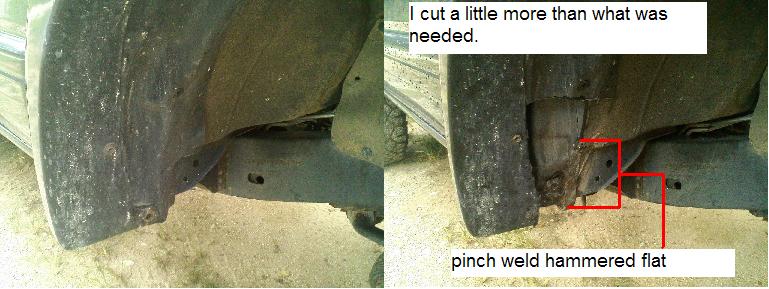

285/75/16s (33x11) or 255/85/16 (33.5x10) will fit with minimal rubbing if you trim the bumper skirt and plastic wheel well liner, and pound the pinch weld on the firewall flat. Please search 1st next time, this is covered everyday.
Is there someone or somewhere on the forum that shows what part of the bumper skirt & the plastic wheel well liner need to be trimmed up in order to fit the 285/75's in w/out rubbing?! Also, where is the pinch weld on the firewall that needs to be pounded flat?

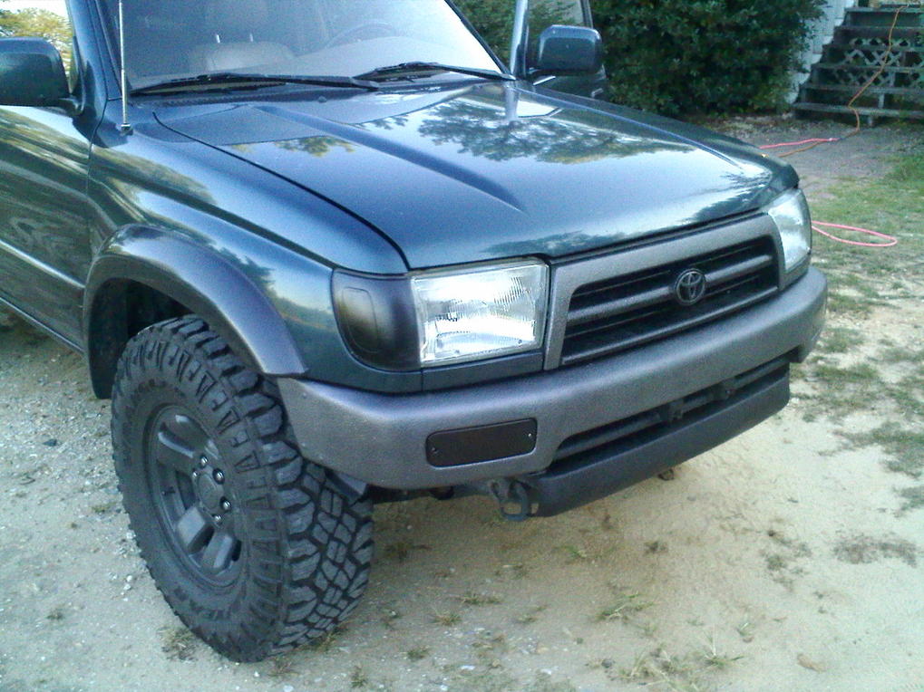

Just trim here like I did. I still get a little scrub every now and again daily driving. Usually when turning at speed into drives with a rise or dip.

Not sure about the front since I removed the flares and cut the lower valance.
