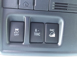

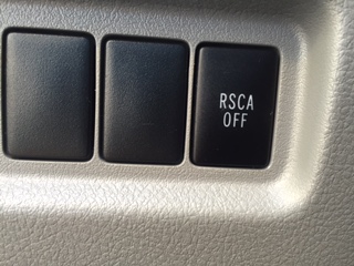

I have a 2011 SR5. Apparently (as the dealership told me) there were different three different differential combinations available (i.e., a couple different limited slip options and a rear dif lock). Is this true? How can I tell which one I have? Can I look it up on line by the VIN number?
I have attached two photos of buttons I have that might be a hint of what type diff I have. Do they help?

Just to clear this up... All 5th gen 4runners (except the super rare 4cyl models which supposedly existed in 2010 - never heard of anyone owning one) have the same front and rear differentials geared at 3.73. The trail and pro editions have a rear e-locker, but this has nothing to do with normal operation or the oil you use. There is absolutely no mechanical limited slip differential in any 5th gen 4runner. They all include brake activated traction control electronics which limit slip.

Mostly true, but just for clarity for future searchers:
- AWD Limited models have a lockable TorSen center differential, which is a form of limited-slip. SR5, Trail, and TRDP models do not have a center diff, just a transfer case. This may be where the dealer got the "limited slip" info.
- [Edited per wfo's correction below] The TRDP and Trail rear diff housings are different from the the SR5 and Limited rear diffs housings. Just enough of a difference that the Toyota factory elocker cannot be installed in an SR5 or Limited without a full axle swap (I checked). All 4WD/AWD models have the same open front diff.
- So technically, the person you spoke to is right... depending on the model a 4Runner may have a combination of open, limited slip, and/or lockable differentials... but the fact they didn't immediately know the correct configuration based on "4WD 2011 SR5" (open front and rear with a center transfer case) is a sign of potential problems. You were wise to call somewhere else.
