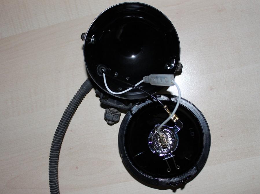

Pretty easy to replace the bulbs...H3 style, for the PIAA 510.
You may be able to reach in under the bumper to get at the mount bolts, depending on lift and how much fender liner has been cut out. Can remove the little filler piece on the bottom edge of the Shrockworks for more room.

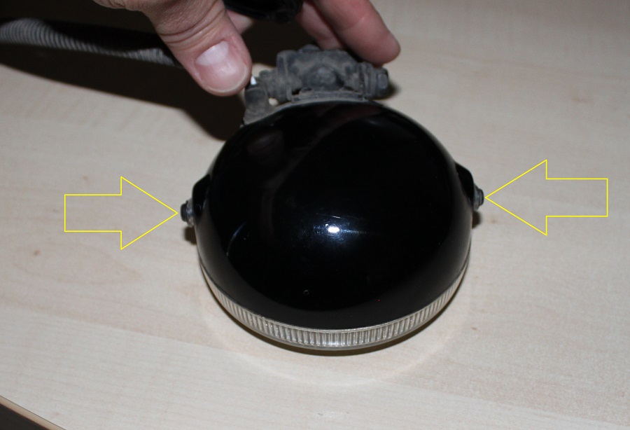

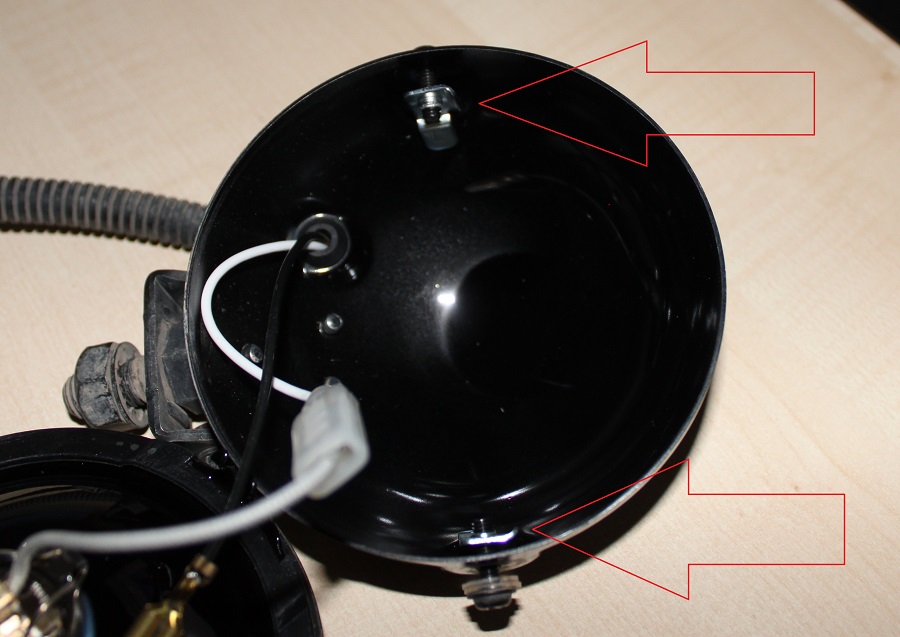

If you remove the side screws all the way the inner holding piece will fall out.
Don't remove the side screws all the way, just loosen them enough to pull it apart.
