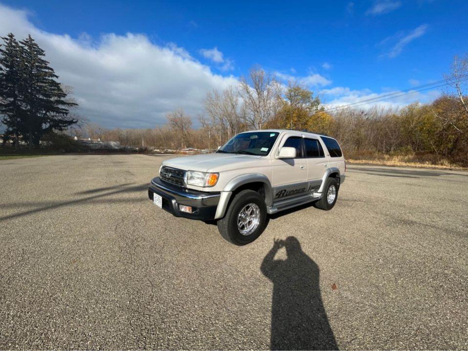

I just purchased a really clean '98 Limited with 126,000 miles to replace my 2000 SR5 Sport that was totaled by insurance after hitting a deer last month.
As soon as you start the vehicle the doors auto lock without putting the shift lever in gear. When I shut off the truck the doors don't auto unlock and I have to manually unlock them to open the doors. My 2000 and my 98 SR5 didn't do this. How do I disable the auto lock function? Any help will be greatly appreciated. I searched the forum and Google with no luck. I did find info for 4th gens and 5th gens.
