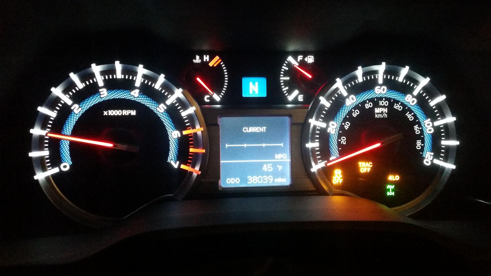

Put the truck in L4 when going slow and over challenging off road features. To go in L4 you must already have been in H4, then you must come to a complete stop, put the truck in neutral, push the button and I believe down to twist to engage L4. There should be a button up on your headliner near light switches with ATRAC, which will help compliment the 4lo if you are in extremely difficult terrain. This should be slow/crawling speed. Do not go fast in L4.
When you are in H4, you will see this green symbol.
When you are in 4lo. You will see this

Wow! Did you just have these these pics ready. Than you for getting into the details. I do have have the knob and will do as you suggested. I appreciate it a lot. I was starting to think I got suckered into the purchase and was just entertaining various thoughts in my head.
