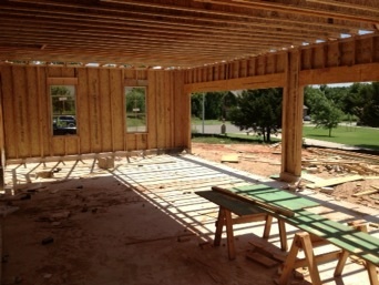

I'm trying to be as informative as possible with documentation, but sometimes assumptions have to be made. I still may do the 895E's pending how much weight I add to the rear with tools and 2 spare tires, my rock rails will have some weight distributed evenly through the frame also.
Once I have a garage again I'll be able to get some of my mods going and test some of these things. 4 car with 2 - 18x8 doors.
