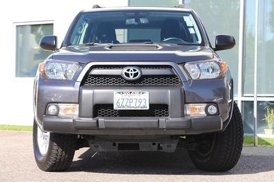

Can anyone tell by this pic of it has KDSS? Thanks all! Super helpful

if you have a higher resolution image it may be possible to tell if you brighten the image a bit to see the sway bar in the shadows
