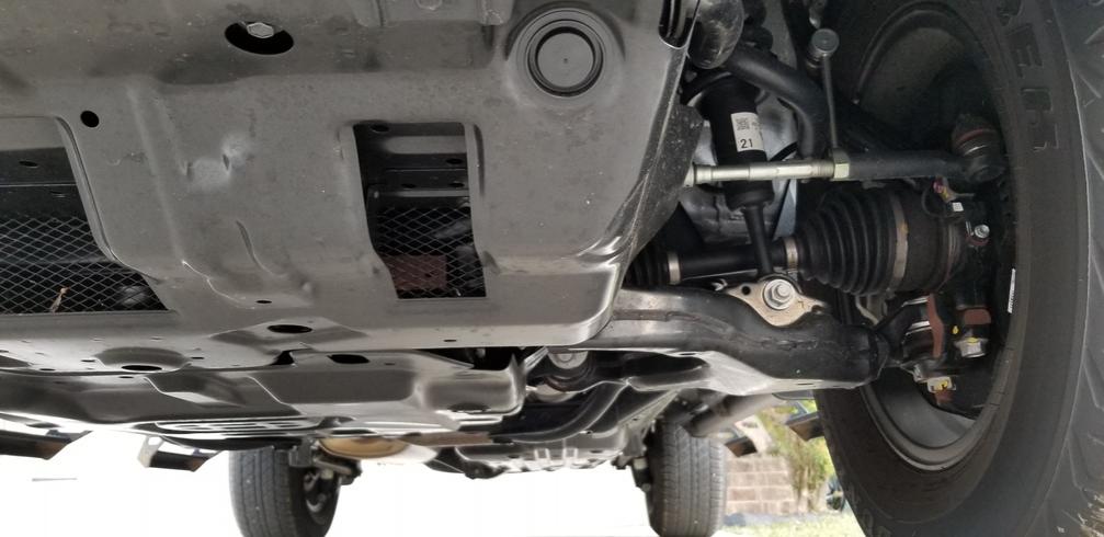

Well I think there is a boot.
Someone mentioned it before but it seems worth mentioning again, check for the dash light. Turn the truck electricals on but do not start so all the warning lights show. The KDSS warning light is on the right side.
No light, no KDSS.

Look for bellows above the sway bar. If they are there, you have it.

Look at the sway bars...a non-KDSS one will have a simple vertical strut connecting the sway bar to the frame at both ends. A KDSS one will have a super fat sway bar connected to a hydraulic piston covered by an accordion boot on the Driver's side and a simple strut to connect it to the frame and control arm on the Passenger side. Does the one you're looking at have an after market suspension upgrade that could explain why it handles well? I test drove our nephew's 2018 SR5 (non-KDSS) and was very disappointed at how it handled compared to our old '99 SR5. Our new ORP with KDSS handles MUCH better, though it still sufferers from a little nose dive if we hit the brakes suddenly.
