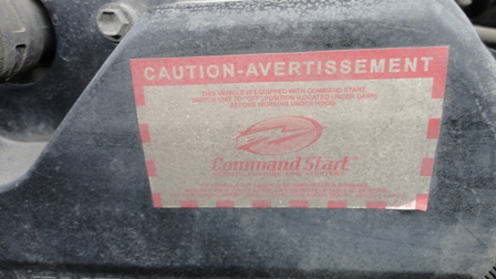

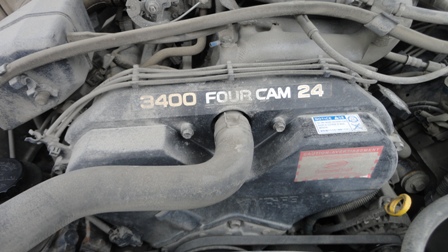

I just got a 98 T4R SR5 given to me and am going to try to make improvements to it as time goes along. It came with 3 keys and 3 "fobs" (one red and 2 black) for the installed immobilizer. But it has no remote at all. It has power door locks and under the hood is the decal as described earlier in this thread (see pics). I've never owned a Toyota before so if some of my questions sound "newbieish", I apologize. Does the presence of power locks mean I should have "keyless entry" capability? How can I tell if the "command start" is still installed? Where would I get a remote control to control the power locks and/or command start? The T4R has 191K km (115K miles) on it and I only drive about 6K miles/year so I'm hoping this baby lasts for many years yet.
Thanks for looking.
