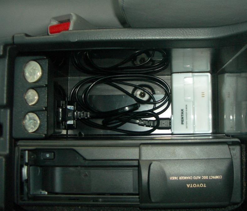

Hello Guys,
I have a 03 Sr5 non-JBL headunit and 6disc changer in the center console.
I have searched and found my answer on removing the head unit, but i did not see anywhere how to remove the 6disc changer from the center console?
If someone can shed some light on this, it would make my removal much easier..
Would like to sell the old unit and changer together:)
it is located in the center console
According to the installation diagrams, it's only held on by the one bolt you see in the top of the picture. The whole thing should come out after you remove the bolt, but you'll have a large hole in the bottom where the wire harness comes through.
