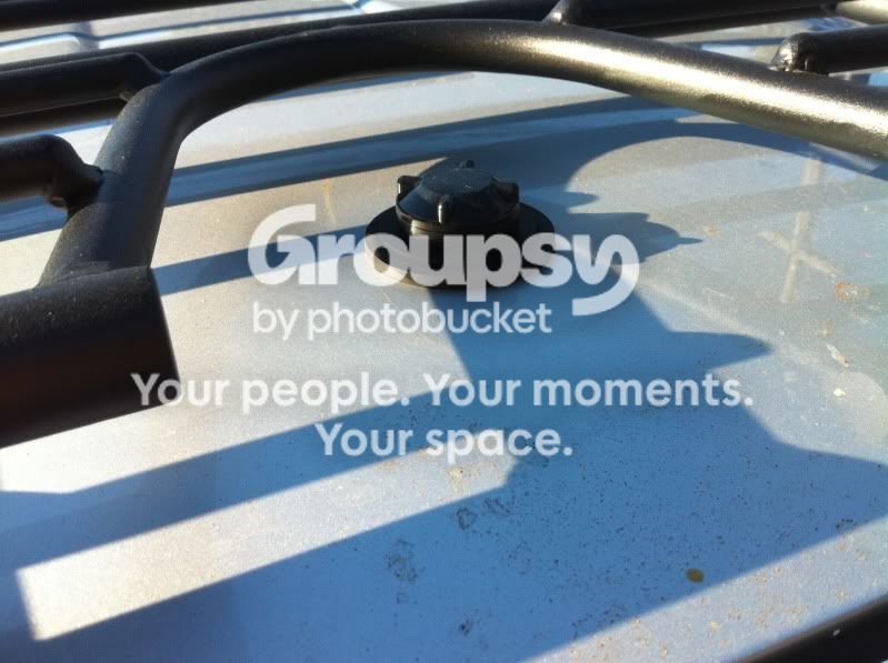

I had installed a Wilson 1000 CB antenna where my shark fin was originally. It's very easy to remove the fin, as SeattleMike mentioned already. I removed the CB antenna and put the shark fin back when I sold the TE back in July.
Here is a pic.

XM makes a low profile antenna but doubt it would be plug and play. If you remove the fin you will have a hole. The pic above shows it covered with a CB antenna mount.
