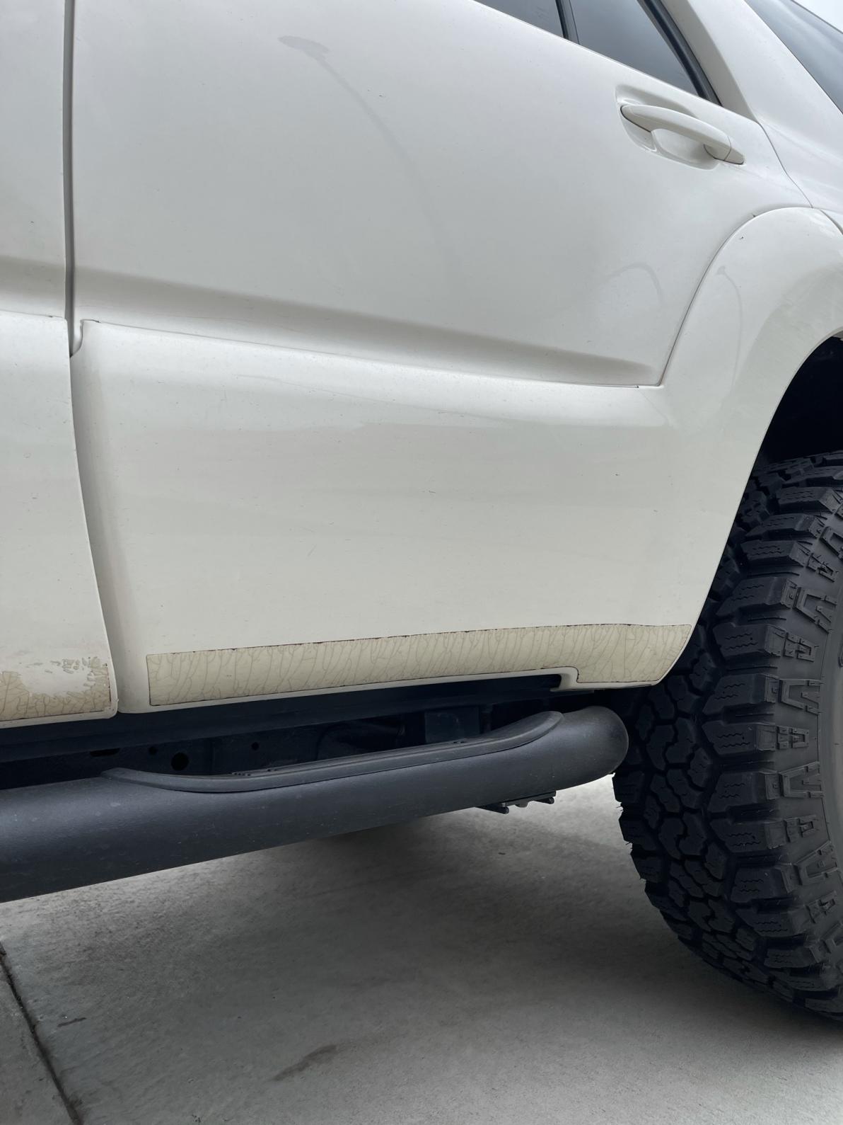

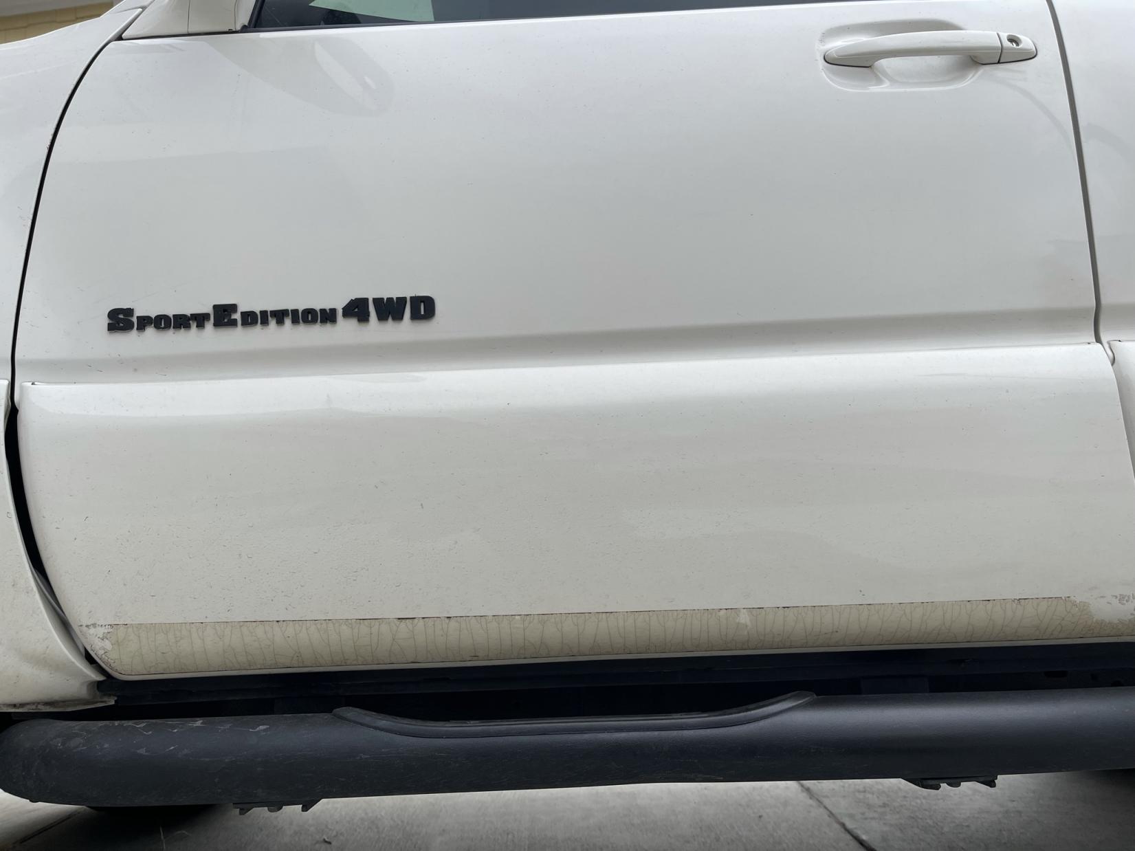

Anyone know how to remove this clear protection film at the bottom of my door panels without damaging the paint?

Heat gun, sticker removal solvent such as Goo Gone, terry cloth and tons of patience.
What did you end up using to get it off?

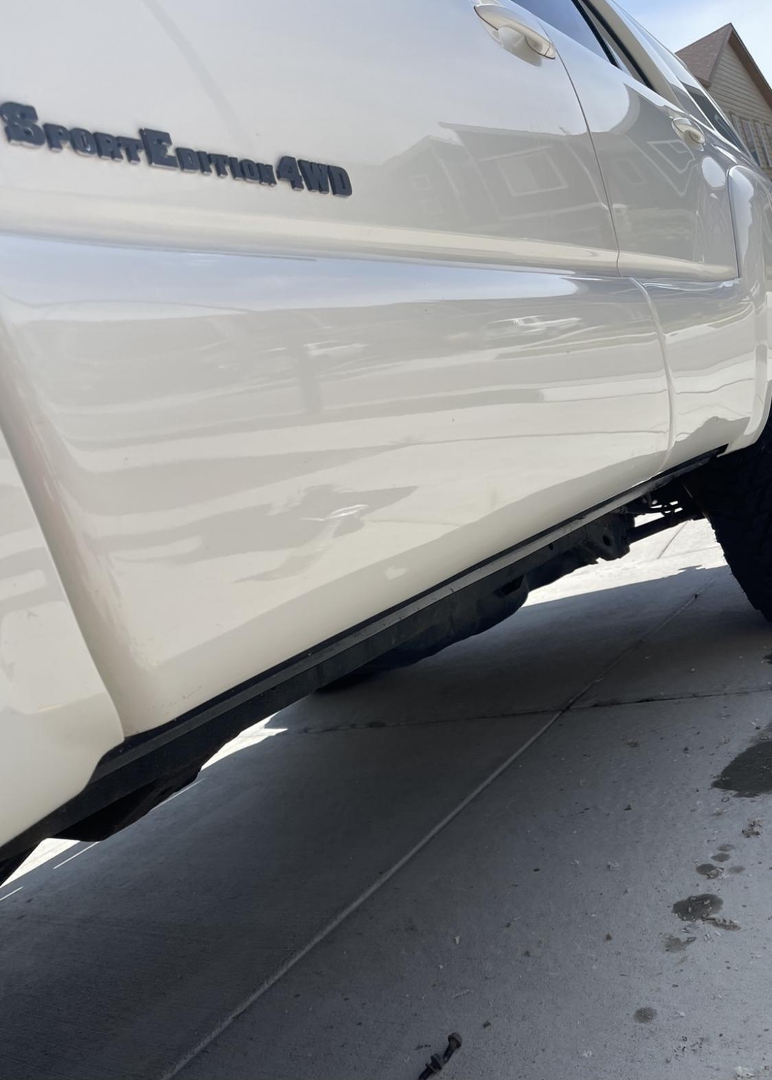

I used a bissell steamer to heat the film then a plastic razor blade to scrape it off. Then I used so pro grade adhesive remover and the plastic razor to remove the gunk left over. At the beginning I was using a decal removal wheel but that was too slow and made a mess.
