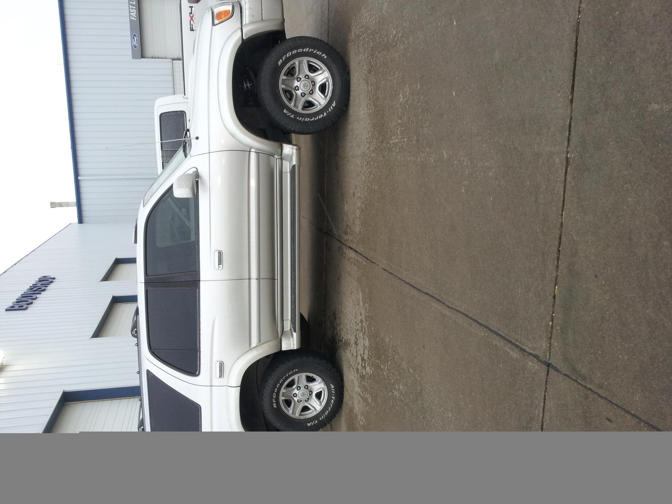

So I finally got my lift on.. Eibachs/5100 and 890s with stock shocks. I have the 5100 set at the bottom notch. I'm 1 inch higher in the front then the rear and about a half inch difference side to side. It's driving me nuts. I'd rather be a bit higher in the back. You guys that have the same setup are you the same?

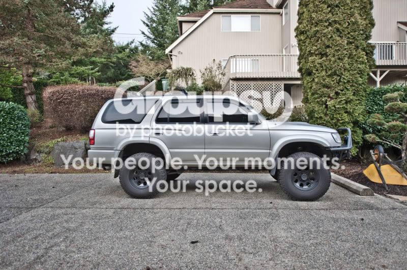

I have the same setup as you, and down below is how I sit. Its slightly higher in the rear, but I also carry no additional weight or spare.
<a href="http://www.flickr.com/photos/chandlerdoom/13050407485/" title="DSC_3284 by ChandlerDOOM, on Flickr"><img src="http://farm4.staticflickr.com/3129/13050407485_cae79735cb_b.jpg" width="1024" height="680" alt="DSC_3284"></a>
That looks great! I need to find out what's going on. My front from ground to fender sits 37.5-38 inches and rear is 36.5-37

You need to measure from center hub to fender lip not ground to fender. Its the only true measurement to show your lift height. Tire and wheel differences affect the ground to fender meausrements leaving you with an inaccurate measurement of lift height.

I measured hub to fender the other day and forgot to write it down, just measured to see what the difference was between front to back,but that is a possibility and would make sense on the perch, I put em on the way they came..thanks!

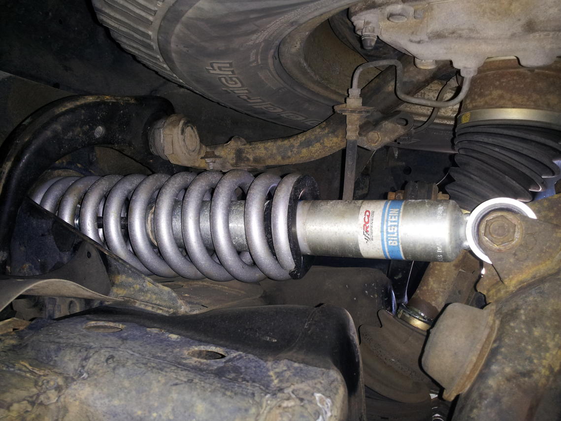

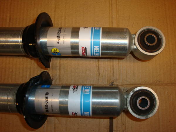

I have the same part number shocks. Not sure if they are Tacoma or not but it's the ones that come up from toytec under our category

I think I totally see your problem....in that pic you put up of your front setup it looks like your spring perch is not on the bottom clip. I think I can see the little indention where you put the c-clip, which would mean you're either on the middle setting or maybe even the top setting. I'm not 100% positive because that strut is a little dirty, but I'm pretty sure I can make out that bottom setting c-clip mark. That would describe why you're higher in the front. You'll need to completely disassemble both front struts and move that c-clip to the very bottom setting ASAP because right now you're getting like 4 inches of lift. At that much lift you're causing a ton of strain to your cv axles, ball joints, etc so I would try to not drive it until you get it lowered. I even see in your pic the inner CV boot spittin a little grease already.
If you only have 3 grooves then you have the Tacoma 5100s. The perch on them sitting on the bottom groove may actually sit higher than the bottom groove on the Tundra 5100s. Tundra 5100s have 4 grooves. I know I have seen a post where someone put standard yellow bilsteins on their 4runner and actually got a lift out of it because of this. The best thing to do is measure your hub to fender and get back to us.
