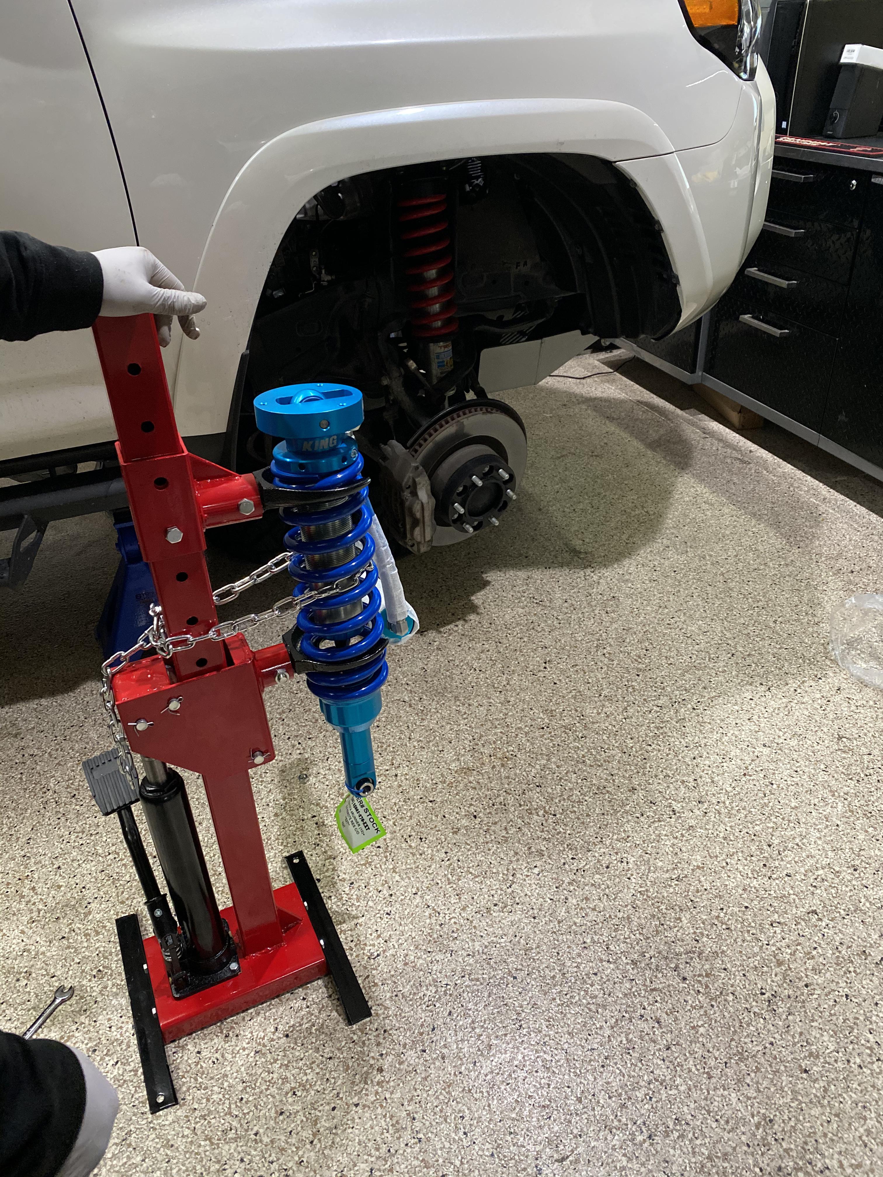

Okay so here’s my issue. I’ve tried the conventional spring compressor and as well as this amazon stand up spring compressor with no luck. The problem I’m having is that kings threaded body sits really close to the inner part of the coil.
When I tried the standard spring compressor, the clamps has two issues. First issue, the clamp itself hits the thread body and does not allow the clamp to sit fully. Second issue is the safety does not clear the king spring.
The amazon stand up compressor almost works. But the issue is the clamps designed to hold the springs is not the correct diameter. So when you try to compress it, the spring leans to an angle. Now at these angles the the clamps contact the kings thread body. I have a few deep scratches in the threads because of this angle issue. But fortunately, the damaged threads are much lower then the collar.

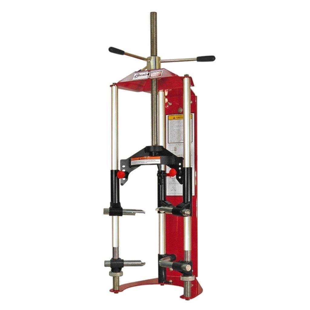

So I continued to search on what other tools can be used. Only other thing I’ve seen on some YouTube videos is this machine Barnick 7600. This tool looks very nice and has so much adjustability. But not sure I would use it enough for the price, $700.
I reached out to a few 4x4 shops in my area and they want $200+ to swap springs (hand carry struts). Really ?
So what I want to know, what do you guys do? how do you swap springs ? Do I pay the $200 to have a shop do it ?

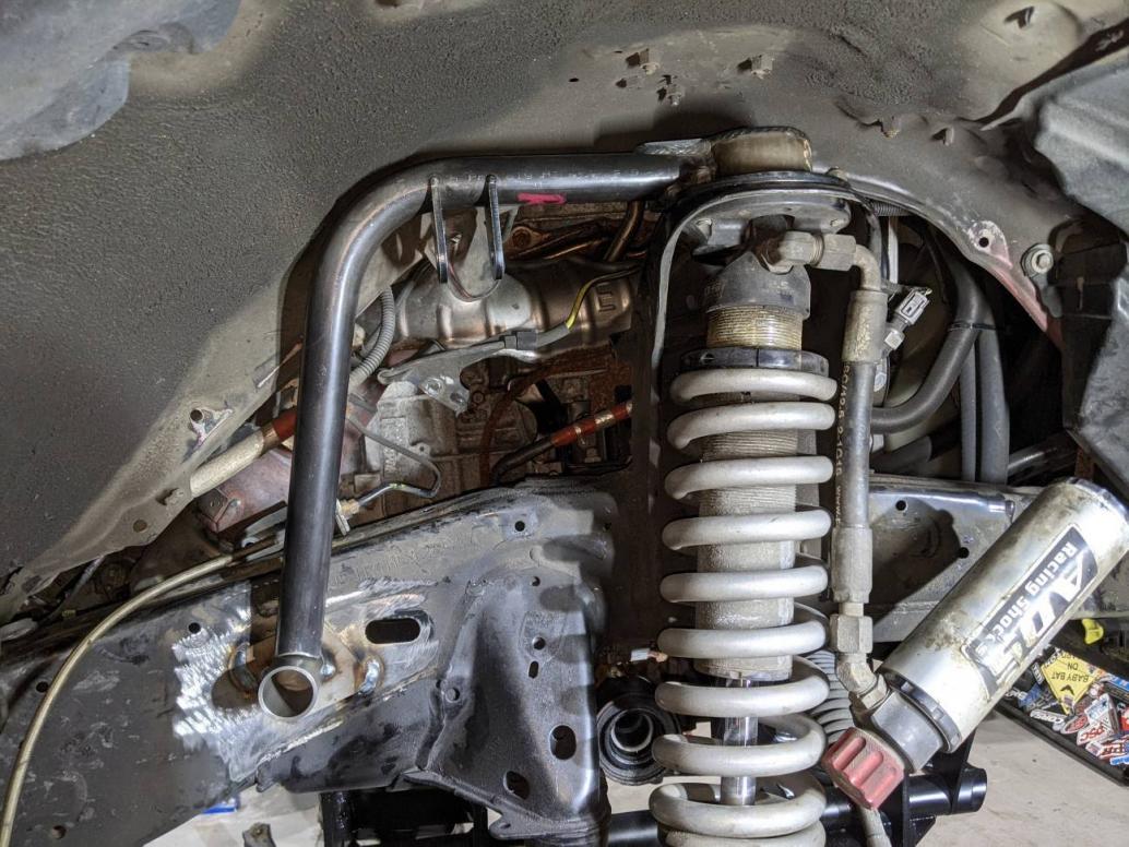

awesome. may get these. do you have any pictures of your ADS coilovers? is it a threaded body design like kings?
i have both the compressors you tried. neither of those would compress my ADS too. the 2.5" coilover springs are very close to the shock body.

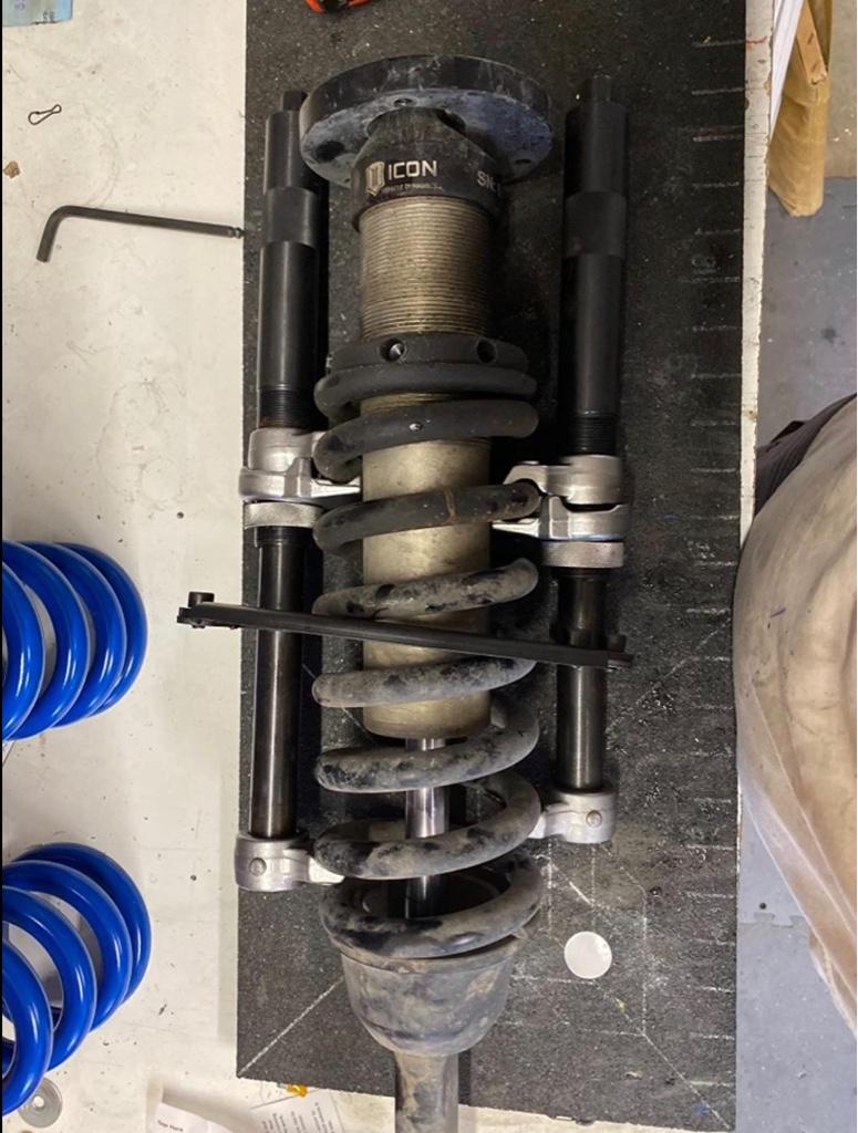

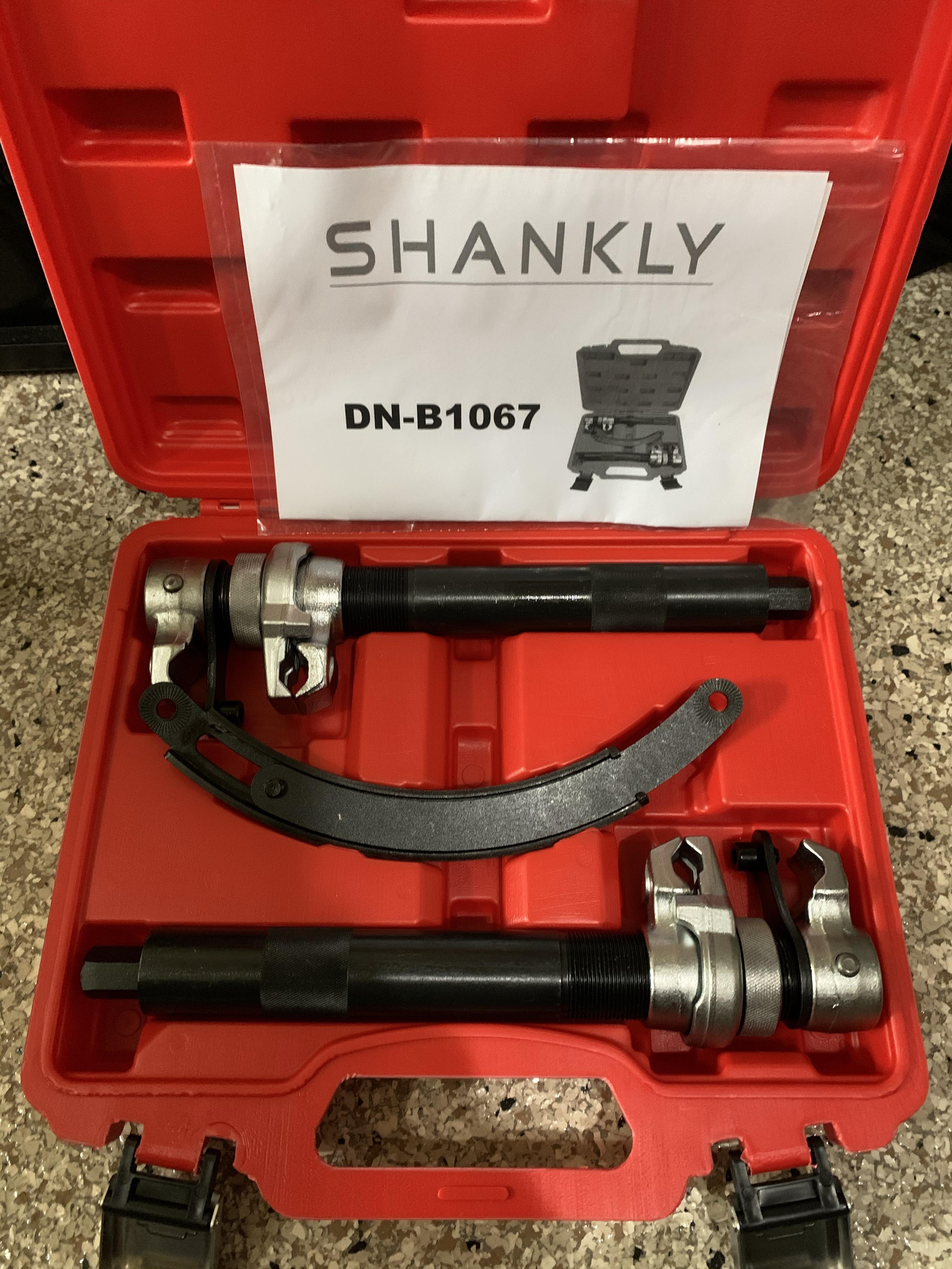

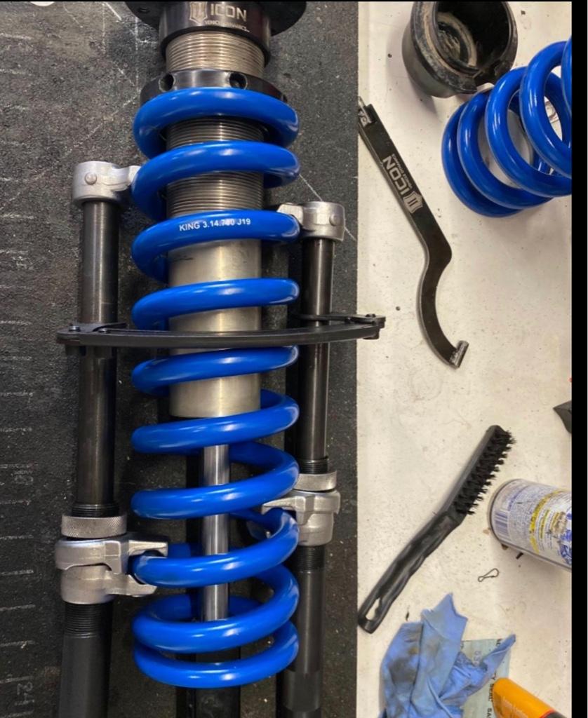

then i got a pair of these
Amazon.com: Shankly Spring Compressor Tool (2 Pieces) - Heavy Duty Build, Ultra Rugged Coil Spring Compressor, Strong and Durable Spring Compressor with Safety Guard and Carrying Case: Automotive
the worked for my ADS

Most of the shops near me have the Barnick compressor. I’ve paid as little as $75 and as much as $150 for switching springs or assembly of all new parts, all carrying them the parts. I could have bought my own compressor by now at those prices.
Yes I was thinking same thing. I’ll try the Shankly first and see how it goes. Else, Barnick here i come.

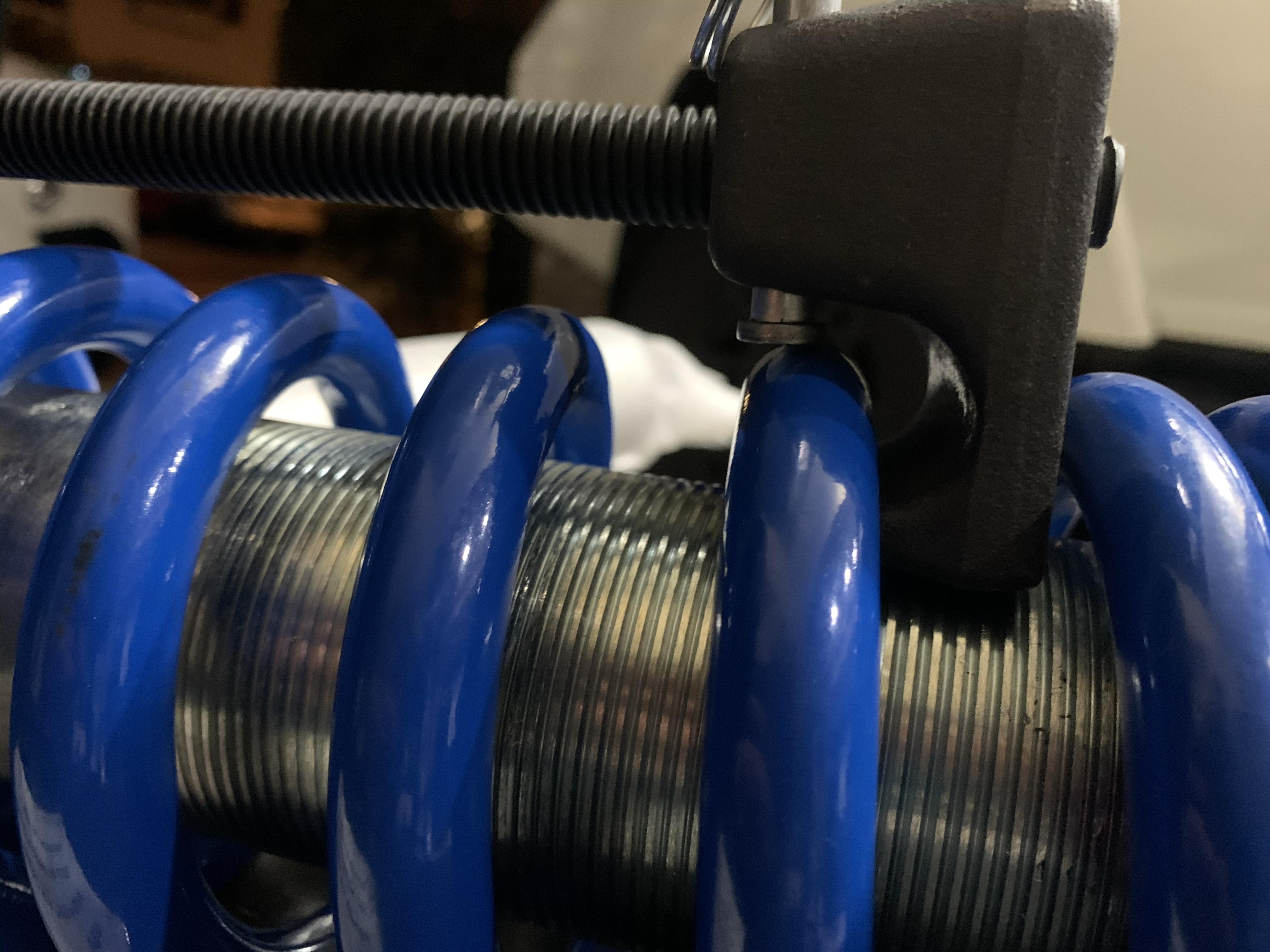

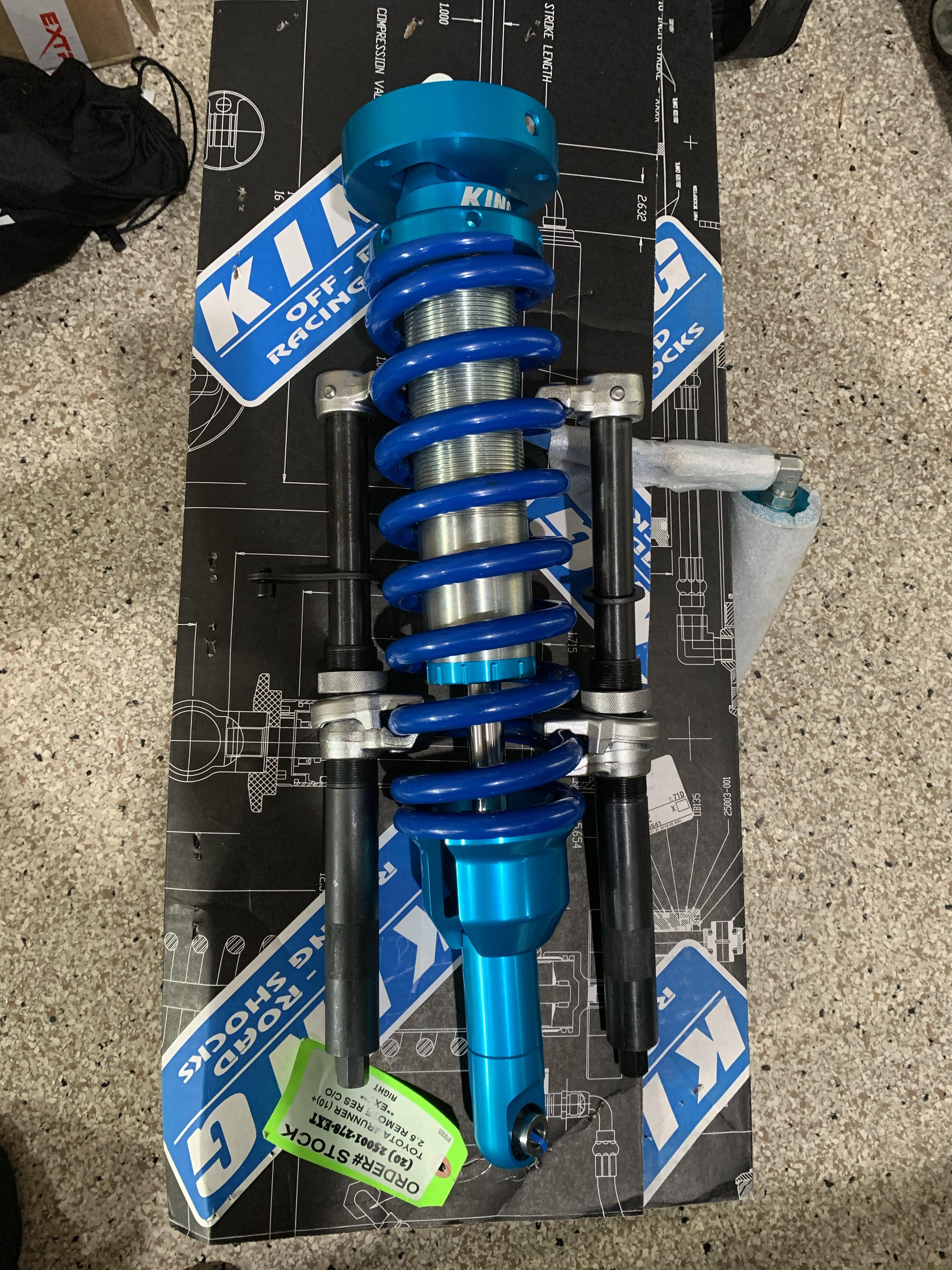

Arrived today. Seems to fit well and clears the threaded body. One thing I noticed is the bolts does nothing clear the safety bar. I may have to drill them out.
