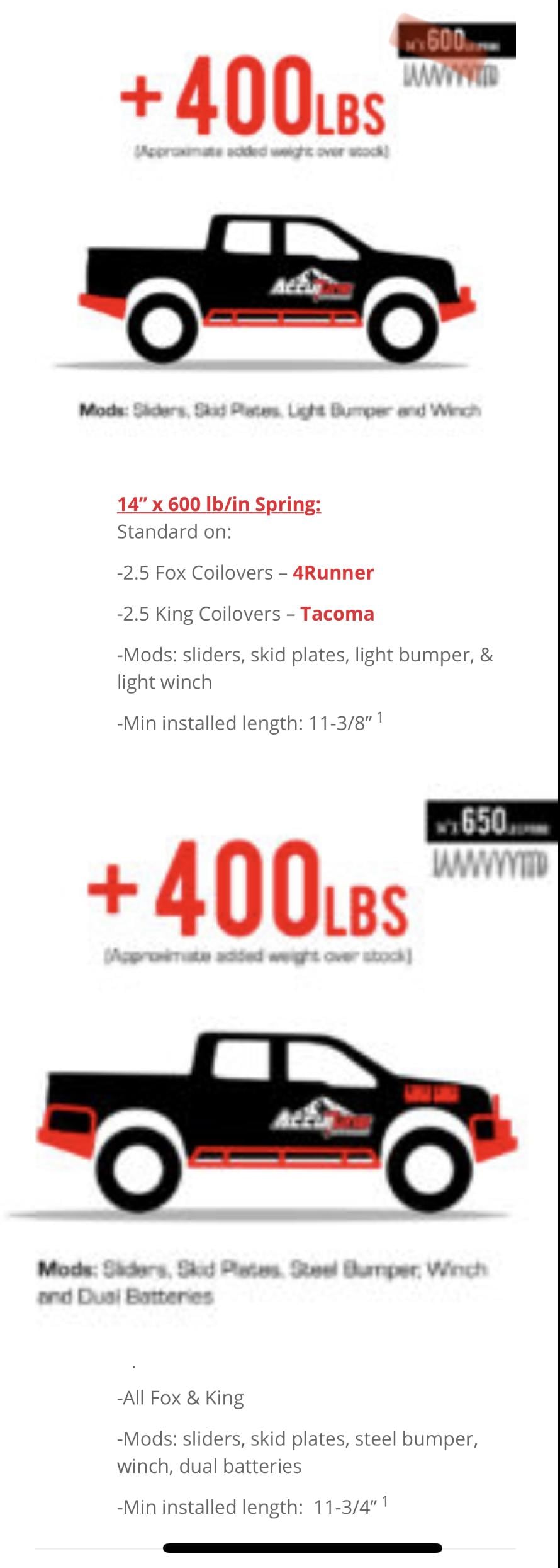

Heavy plus on not over springing. I'm just under 300 lbs over stock in the front with winch, alum winch bumper, compressor and second battery. Just like most folks I thought for sure I needed to stick with 700lb springs for my KING setup. However, I'm running 650 and have almost zero preload getting me up to a little over 2.5" of lift. The ride is absolutely perfect.
thanks.. i'll most likely move up from 600# to 650# also.
That was a good read. So I should be either 600# or 650# according to accutuneoffroad. My C4 low pro winch bumper is made of steel. I also have the high clearance bits as well. Others items : gobi rack, rsg sliders, winch, skid, bumper light bar, gobi light bar
Which one should I choose ?
