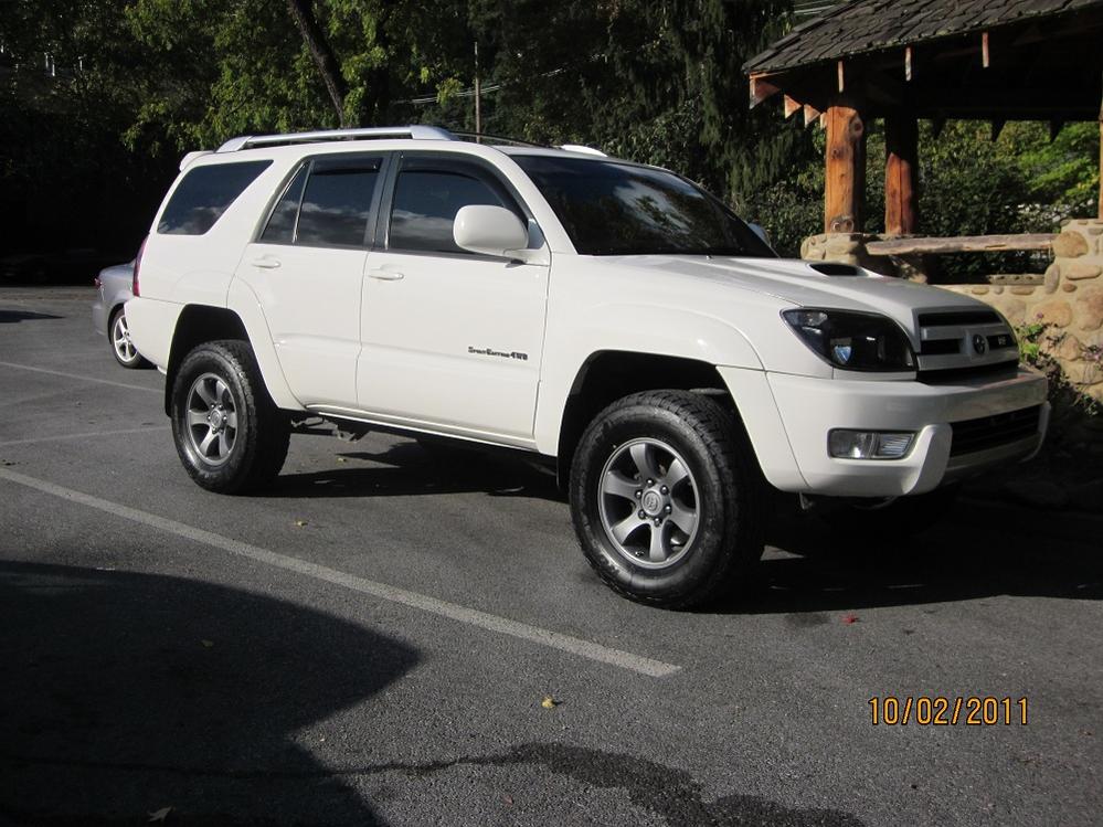

Until recently I had fj's all around with a 1.5" in rear and a 1" daystar budget boost in front. Worked great for several years. With 265/70's was 36" in front height and 38" in rear fender measurements.
I have since changed to a different setup. I am actually in the process of cutting my 1.5" spacers down to a 1" thickness. Here is a pick of the old setup
