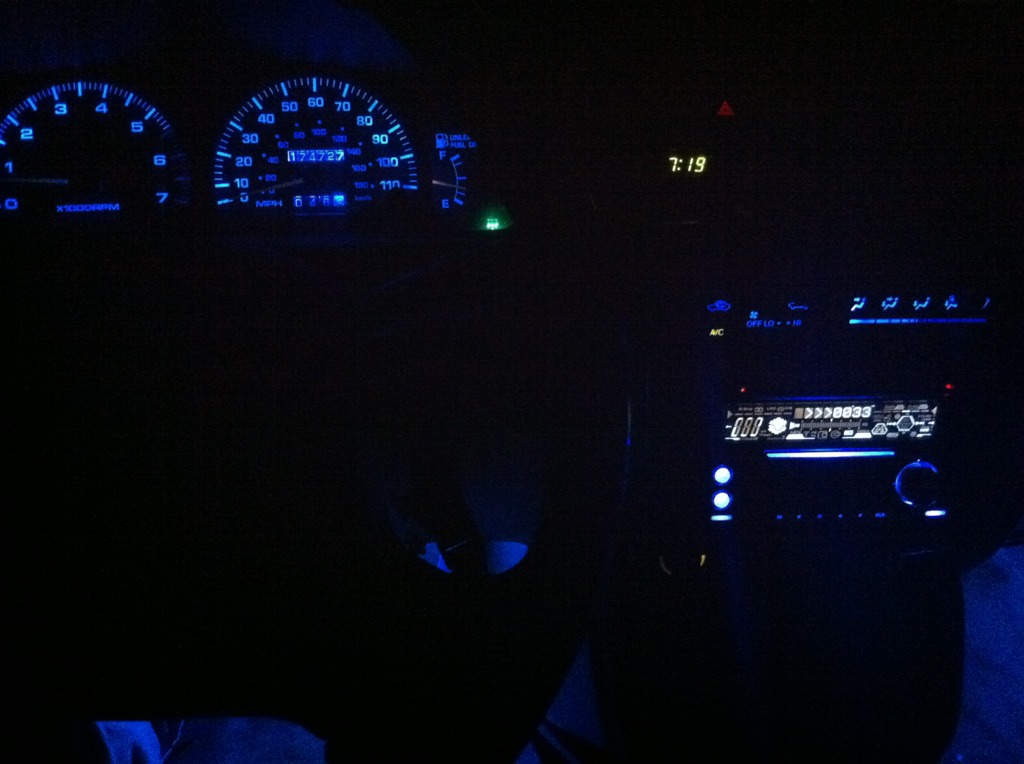

I just wanted to post a reply to say that I completed the installation of LED's in my 1996 4runner and it looks great.
I purchased blue vleds and have attached a pic so everyone can check them out. The installation wasn't too hard but you really need to stay organized with the screws. I put them in separate ziplock bags and labeled them as I worked.
Thanks for the help!

haha yeah man that's how I felt. It ended up taking me about an hour and a half to finish. The blue lights on the floor are blue neon lights that I installed a while ago
unfortunately the clock LED can't be changed... However I think the A/C one can be but I left it green... for now at least.

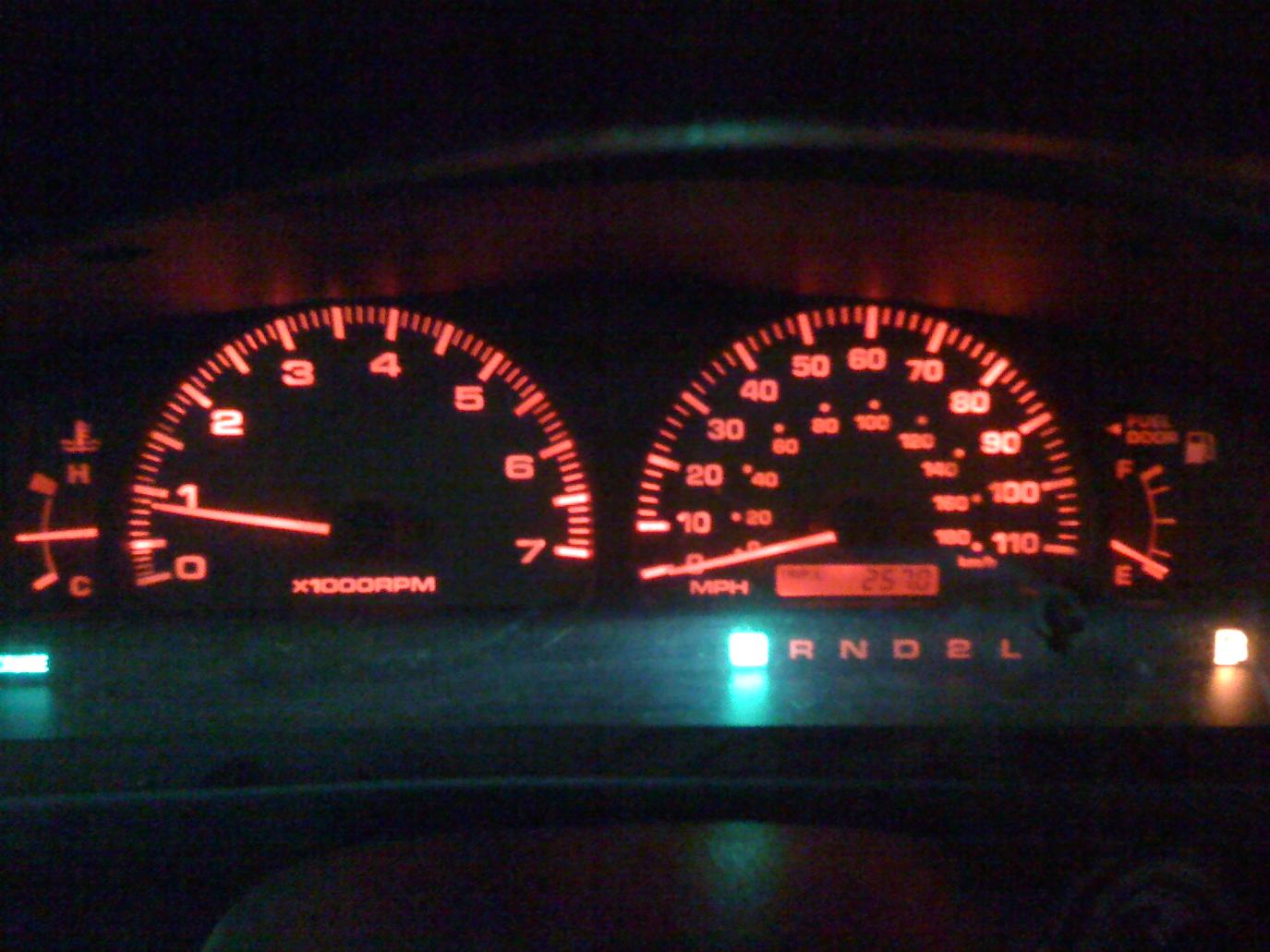

So, I did this on my first 4Runner when I turned 16 and had the mod bug (about to turn 18). I used Superbrightleds.com and went with red...it's my favorite color.
It has some hot spots, but it wasn't bad or bothersome to me at least. I did the dash and center console, but unfortunately I don't have a picture of the center.
And I apologize about the HUGE picture, iPhone camera sucks and I couldn't compress it any haha
