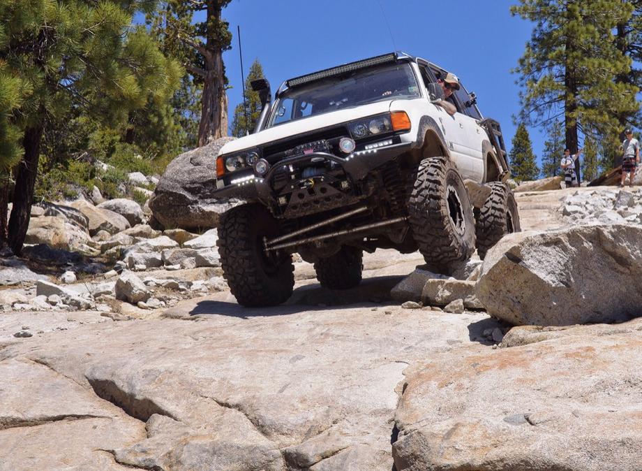

I run them on my 80 series, as others have mentioned not intended for daily drive use. My 80 is a dedicated trail rig that drives to and from the trail. Pretty awesome to drop down to 5psi and not worry about blowing a bead or spinning tire in rim given the weight of my rig.
-A
