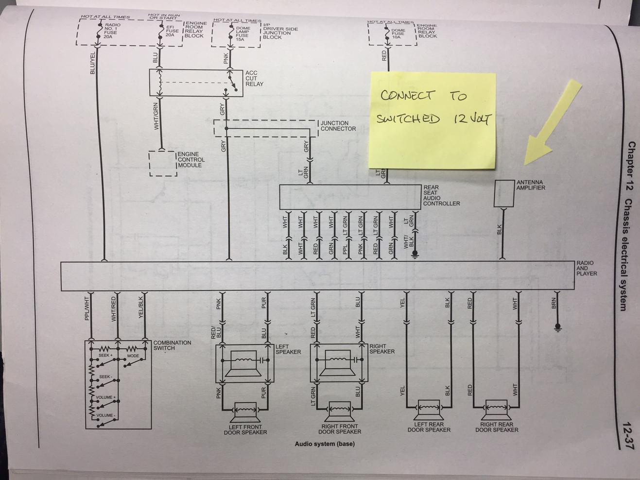

When replacing your head unit don't forget you have to get power to the factory antenna amplifier.

Do you happen to know which factory wire that would be?

It differs on the radios.
In my case, I had the Ltd. JBL Synthesis system and it was the black wire on the harness.
I put a meter on the radio and checked for the switched B+ to confirm.
Then once it was hooked up, all was good.

Connect a switched 12 volt to the black wire.
