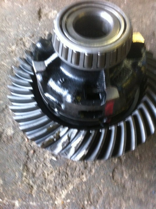

My diff went out on my 2006 4Runner with only 65K miles. Of course it was from powerbreaking and having fun. :/ they arent built that strong I can say that.
Differential with the broken gears.
