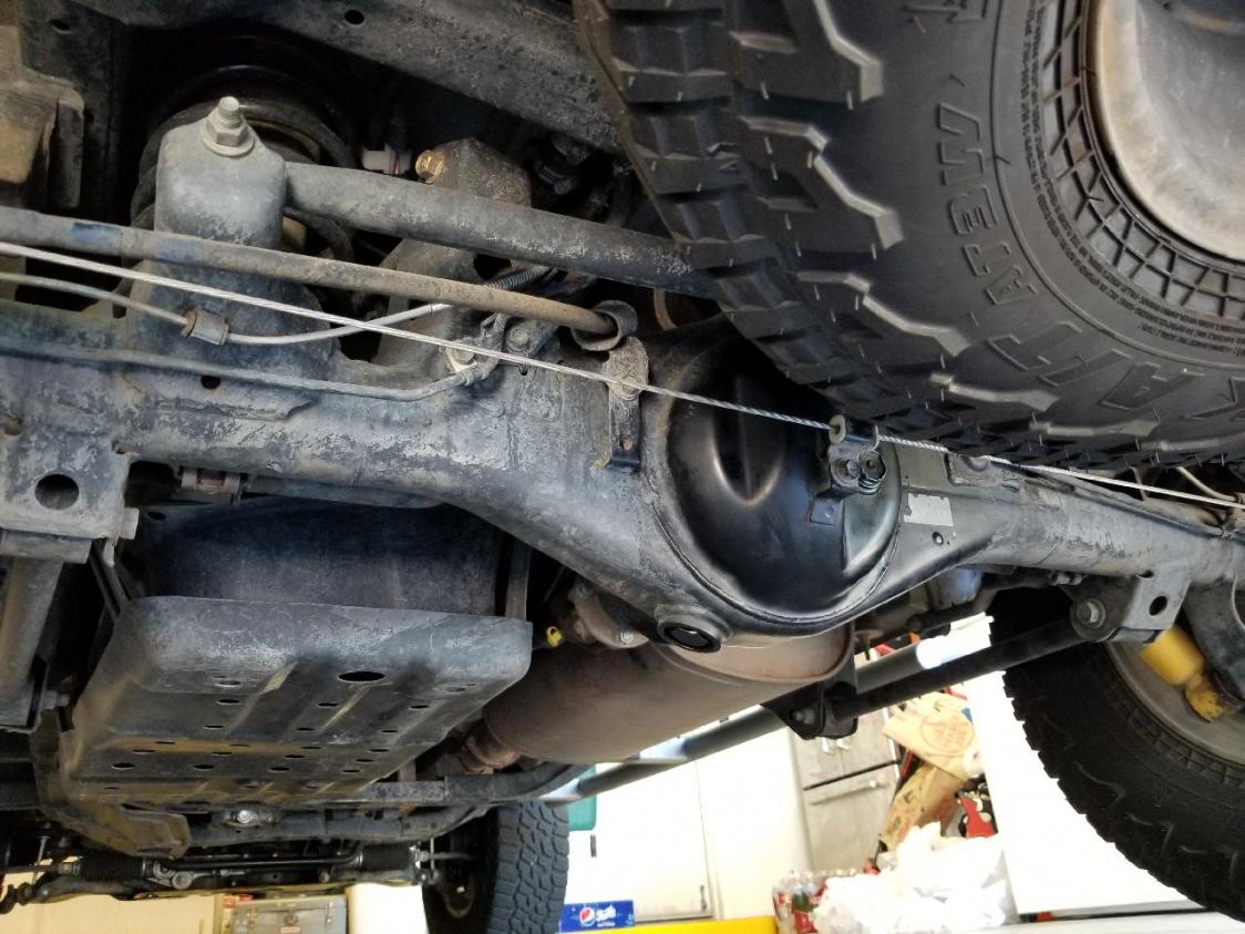

I could not look away from your undercarriage. It is in such stark contrast to mine. Silly I know, but I'd be afraid to drive that thing.....way to spoiled by rust free cars out here.
My diff is all shiny cuz I changed the gear oil a couple weeks ago, otherwise it'd be way dirtier. :D
My diff is all shiny cuz I changed the gear oil a couple weeks ago, otherwise it's be way dirtier. :D
