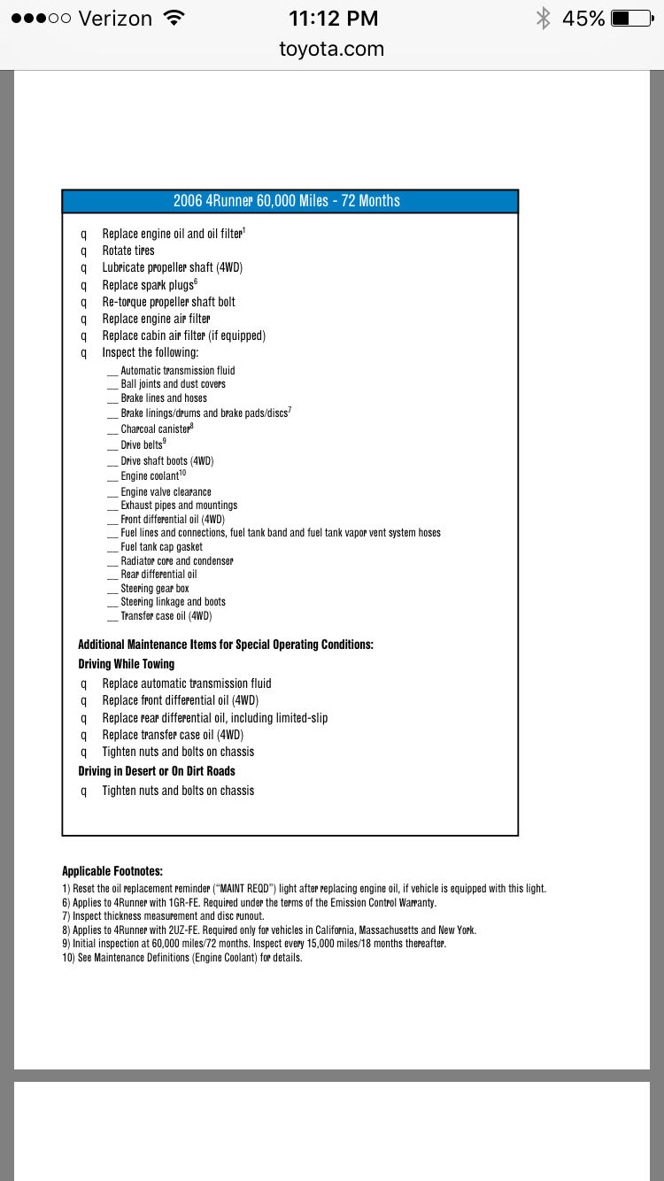

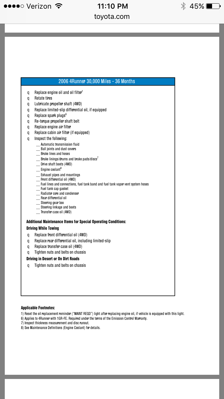

I think you're taking a very BIG gamble no matter how conservative you drive, it clearly states in the service maintenance guide that if you tow a trailer at all that you should do a transmission fluid change at 30,000 miles and every 30,000 miles after that, I also personally think it should be done around 100,000 even if you have never tow anything, there is truly no such thing as a "Lifetime" fluid when it comes to transmissions.
Anytime you tow a trailer the temperature of the transmission fluid rises past the maximum recommended for any transmission and as such shortens the life of the transmission, the only way to avoid the temperature rise is to have a good transmission fluid cooler and also a way to monitor the transmission temperature level, if it's get close too or definitely above 200 degrees for any extended length of time you're risking or more than likely have done damaged to the transmission and another or bigger cooler is required to avoid the damaging temperature levels.
I speak with over 45 years of experience of doing mechanical work on cars, big rigs and heavy equipment.
I think it's every 60k towing
