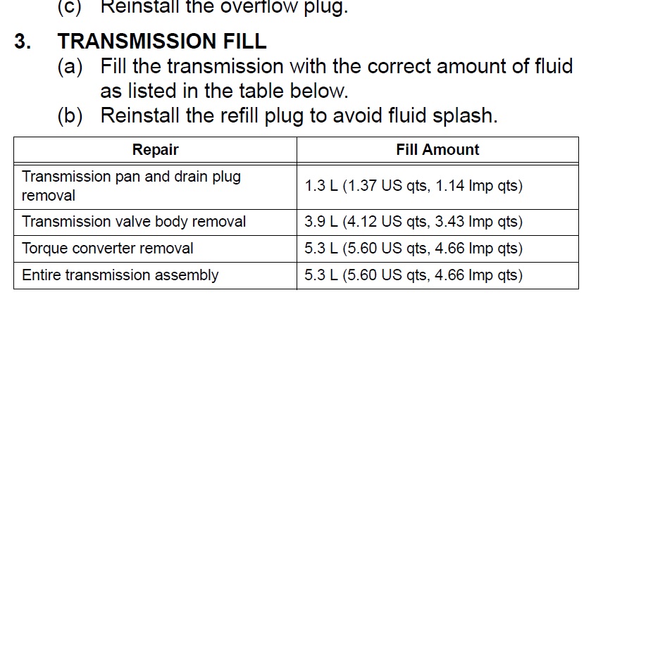

Follow on question: How much fluid is really in that transmission (A350F)? People on this thread give numbers like 12-14 quarts, but the FSM has the following table, which indicates the entire transmission assembly only takes 5.6 quarts. That's a big difference from 12-14. Anyone know the actual answer?

I wonder if that chart is a breakdown by major sub-assembly... The "entire transmission assembly" could be the gear housing, or whatever it's called. I mean, the torque converter and valve body are part of the tranny. Thats almost 10 right there, and the 1.37 qts in the pan? I can go out to the garage and dump ~4 qts from the pan right now. That 5.6 qts in the "entire assembly" just doesn't make sense as all the fluid. Obviously, I'm not a Toyota engineer, but that's my take on the chart..
