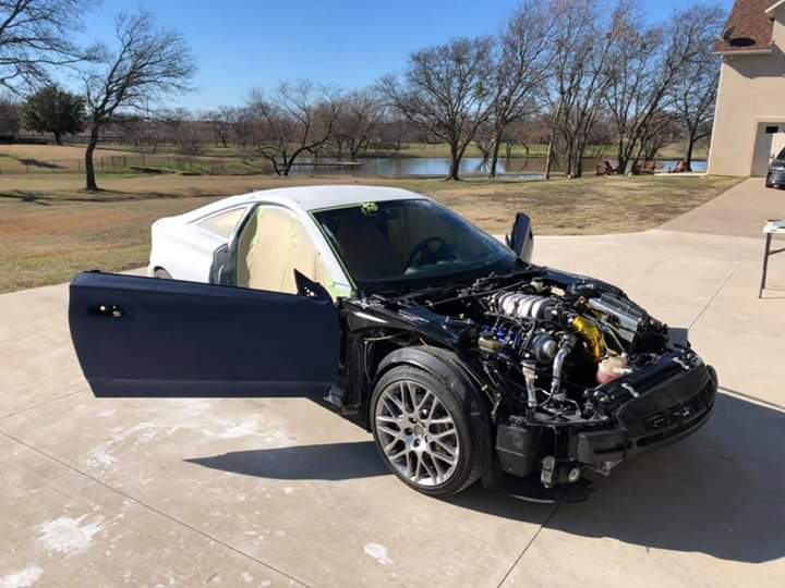

This V-8-Swapped Celica Is the Toyota Sports Car We Need
Funny how I have pics of this on my FB feed from some guy I" claim to know". I bet swapping a V8 and rwd into a Celica isn't recommended by the engineers either... better yet, how about an 01 Camry 2grfe 5spd the pilot plant engineers play with at the plant here???
