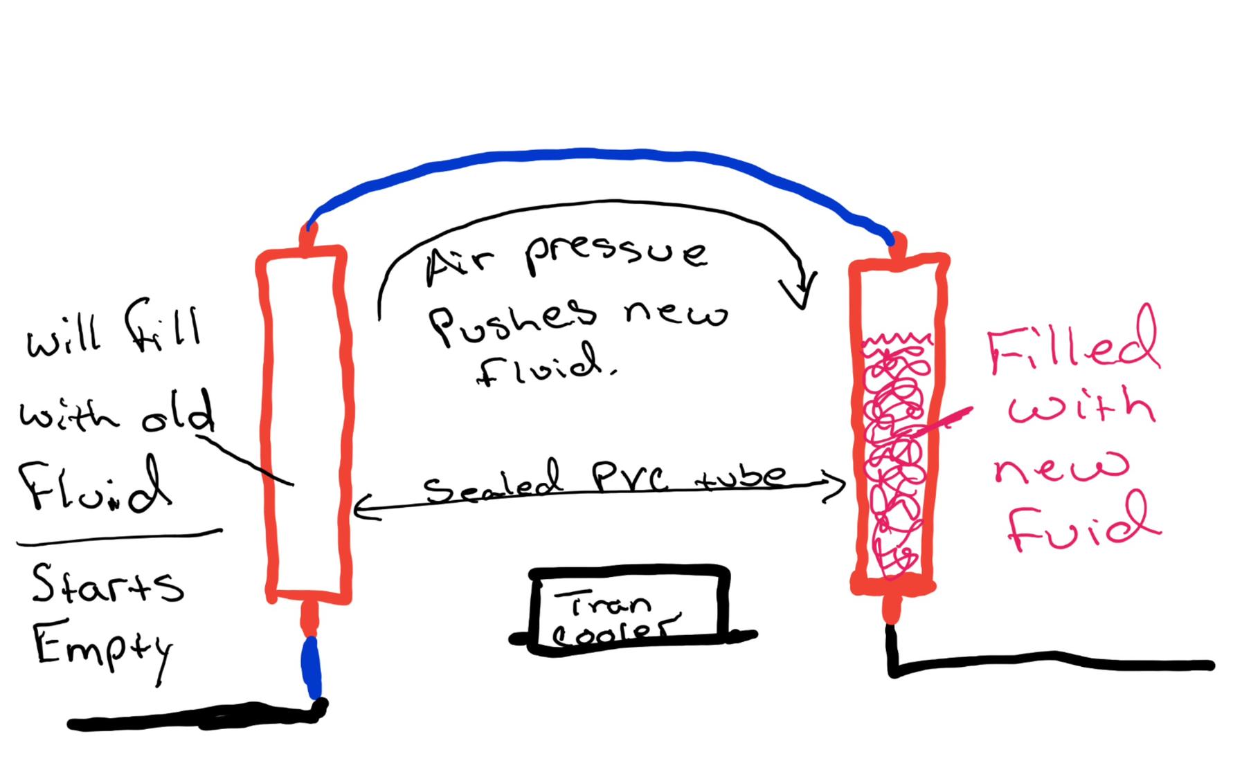

So theoretically, if I were to do the bucket meathod, the pump would drain, but not fill. I wander what kind of pressure those lines build... I could probably build a closes pressure PVC pipe system to get the same affect as the thing they used. Hold on and I'll draw my theory out.
Pardon the roughness. I did this quickly on my phone. The blue would represent clear lines which could be used to monitor old vs new fluid.
Be gentle. I'm at work, so only so much time to think through this.
You'd need a barrier and a hydraulic fluid of some type between the chambers, the air would just compress in your diagram.
It is physically impossible to compress air in a closed system. The air would pressurise and force the new fluid into the return line.
Edit: I think you mean the system will decompress somehow, but the whole system would be sealed
It is absolutely possible to compress air in a sealed system although, what you drew may work depending on how much resistance the new fluid encounters while being pushed into the transmission. A hydraulic/hydraulic setup that uses a floating piston like that earlier pic would be ideal as there is no way to compress a liquid such as ATF, so what you put in is what you get out.
Except that the transmission and associated cooling lines are NOT liquid full. You cannot guarantee you're replacing equal amounts.
If they're not liquid filled, what's in them? If you use two cylinders that were both marked, you should be able to tell how much is coming out vs. how much is being pushed back in. Of course you would want to verify the level using the temp check method and add or drain as needed.
Okay, I've slept, and my head is much clearer. 12 hour night in a busy hospital tends to distract you. You're right.. air will absolutely compress in a closed system. However, the air would compress to the appropriate PSI, and eventually start forcing fluid in. I would just need to be sure that I incorporated some kind of check system to be sure all of the new fluid was pushed in.
The cylinders would need to be connected to create the pressure needed to push the new fluid in, but otherwise I couldn't agree more.
