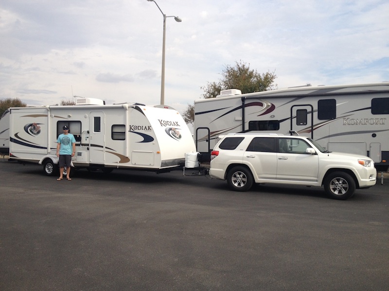

Gus what was your pic of?
What I tow.
This is the camper that I tow with my 2011 SR5 4wd with only an electronic brake controller installed. All drivetrain components are stock and no additional sensors have been added. I have towed it from Tampa to western Colorado through the Rockies and back with no problems. I have put about 10,000 of the 32,000 miles on my T4R just towing this camper. It weighed #4300 dry and sits right around #5000 +/- #200 loaded.
Nice rig hambone! Curious did you add a tranny cooler or anything. Another thread on here went on and on about that and the heaviest load was 5500. Out of curiosity what kinda mpg you get hauling that?

Thanks Mallory, I get a lot of use out of it and enjoy it immensely. I have not installed an aftermarket tranny cooler or any gauges so I cannot say what the transmission temperature was running. Prior to leaving Tampa I had a 30,000 mile service done and was told that transmission, rear diff and transfer case fluids were all in great condition. Upon returning after a month and 5,000 miles later through steep grades I had all fluids checked again and none needed replacing.
For peace of mind I will be getting the ScangaugeII soon, my fuel mileage was less then stellar as I average anywhere from 10-12mpg overall while towing. Ive kept MPH anywhere from 60-75 and the T4R tows and handles great.
Correction to my first post, I have a a load leveling hitch with sway control but nothing to the T4R itself.
