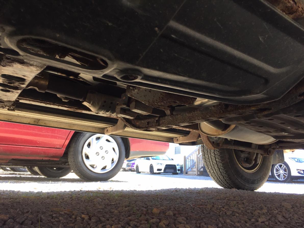

A 2008 I'm looking into...photo from dealer:
That looks pretty nasty, specifically that lower radiator support and frame rails where the bumper reinforcement bolts up.
Ewww. We replaced the lower radiator support on my 2003 T4R because it was pretty rotten, and it looked very much like this one. That radiator support probably looks even worse in real life. The problem with some of these frames is they begin to rust from the inside out. With substantial rust like this already showing on this 2008, who knows how bad the inside of the frame is rotting. If you don't want a special needs truck that needs patching and welding, you might want to walk away from this one. If you are super handy, perhaps you could get this for a good deal and fix it yourself.
Iirc they are asking at least $17K for this one
I'll walk
oh and on that one above the dealer called it "surface rust" and said they'd be more than happy to remove it and undercoat it if i wanted it.

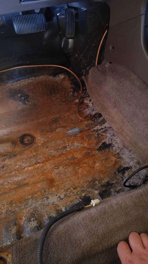

Aside from the frame rust, potentially could have the problem my 3rd gen has from the carpets always being soaked from melted snow (I'm assuming):
I've since sanded and hit it with Rust-O-Leum, which still isn't ideal, but something like that you won't notice until it's too late in most cases.
Aside from the frame rust, potentially could have the problem my 3rd gen has from the carpets always being soaked from melted snow (I'm assuming).
I had wet floors and thought it was my sunroof drains. So I ran some fish tape through them both and it didn't fix the issue. I blew some compressed air, same thing. Come to find out there was so much crap (leaves, mud, sand, rocks, etc) in the bottom of the front fenders where the sunroof drains through that it was backing up and coming in through the antenna wire hole (passenger side). I ended up pulling the fender lining out and sucking as much debris as I could with a shop vac and then hitting it with a pressure washer a few times.
Hasn't been a problem since.

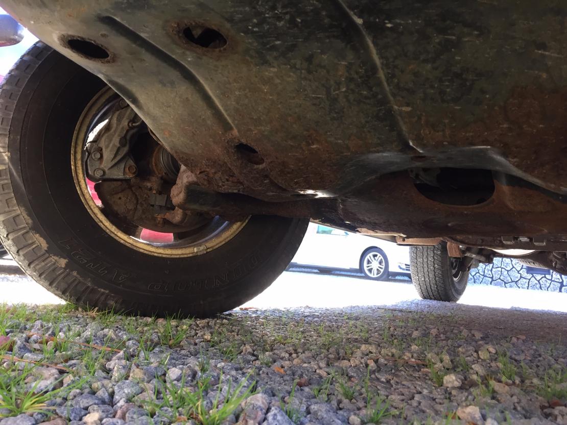

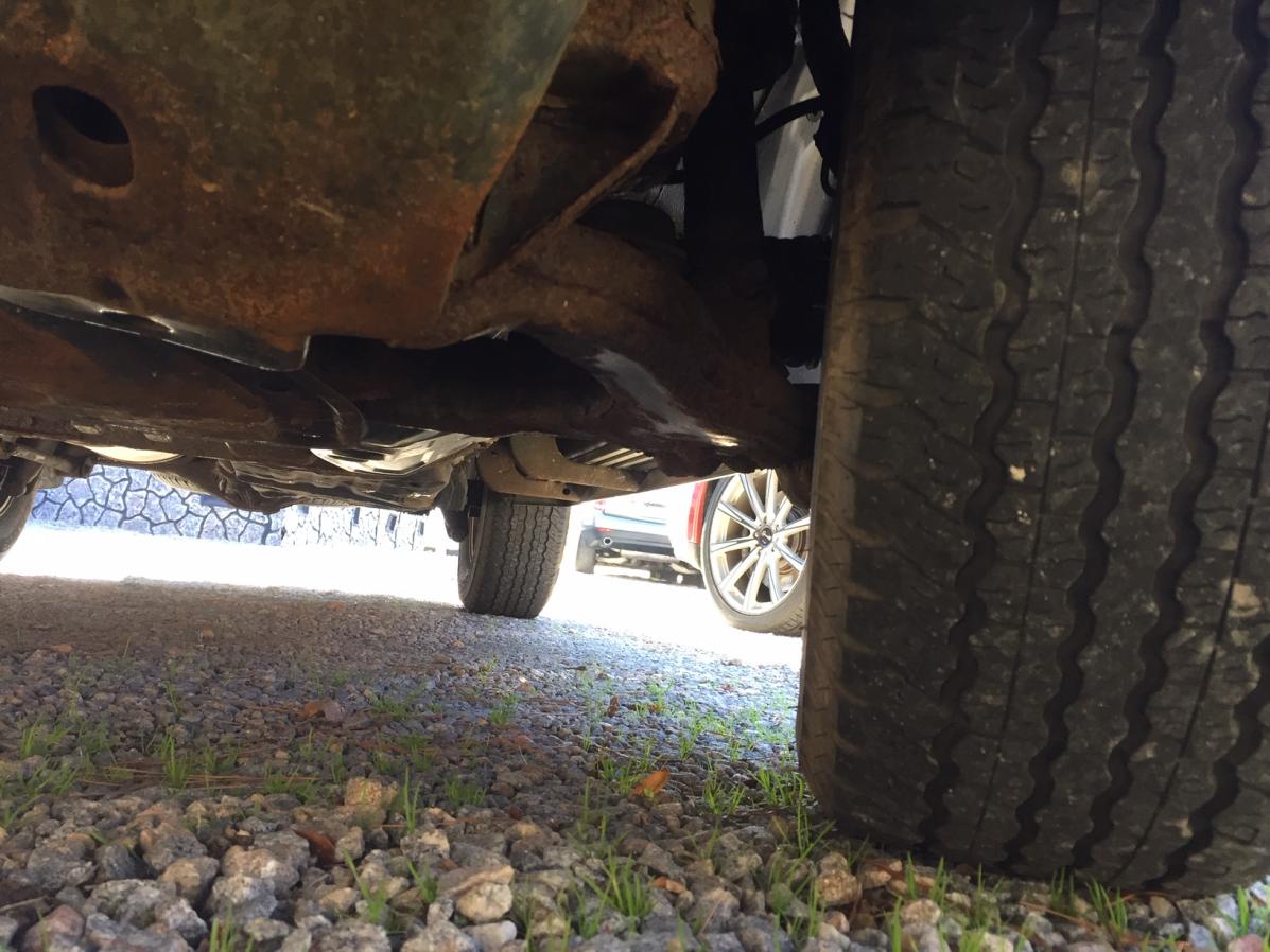

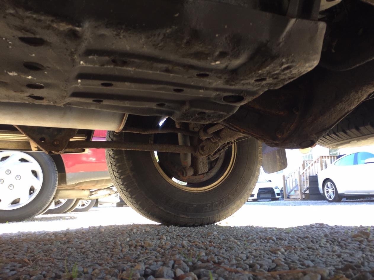

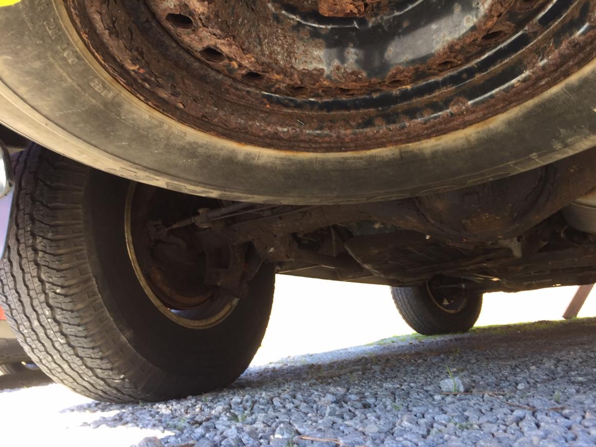

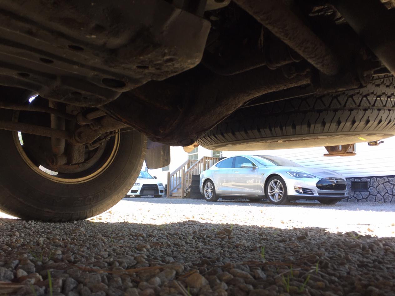

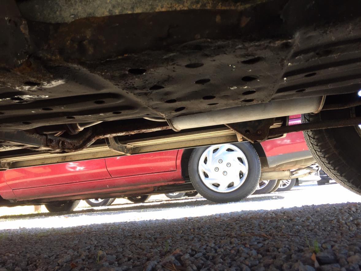

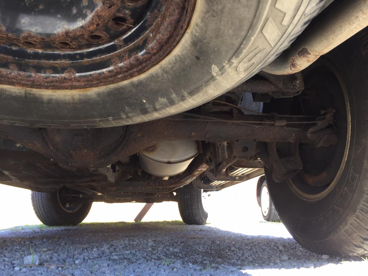

Hi all - Looking for advice. Potentially purchasing a 2002 SR5 with 91k miles on it. Issue holding me back at this point is rust (the vehicle is from MD). I've attached pictures. Any advice would be much appreciated.

^ I'd keep looking if I were you. Too bad considering the low miles but that rust looks like a can of worms waiting to be opened.
Maybe if you could get it really cheap for like $1000, mine had a similar amount of rust, not quite as bad, and I’ve spent probably hundreds of hours with a wire wheel, welder, and por15 trying to correct it, not to mention every time you need to remove a bolt it’s a complete nightmare. Whenever I replace something under mine I’ve gotten in the habit of buying all the parts in the way of the one I’m trying to get to because I know they will have to be destroyed to be removed
