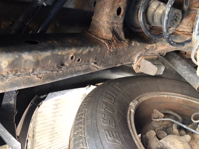

So i just joined the 4runner family. Friends daughter was selling her 2003 and i needed something to haul up north maine. I inspected basics of the car but noticed them gem today.
How screwed am I? Repairable, normal? Just run it till i can afford one that isnt rotted.

I understand you can't travel, my recommendation is to contact a broker who can get you a vehicle from the desert southwest. You'll pay about $1200 for shipping but you'll get a rust free truck for roughly the same price as the ones you're looking at.
OR go through CarMax and check out their dealers in places where they don't use road salt and have them transfer a truck for you.
It might sound extreme, but having lived (and wrenched) in the northeast for almost 20 years I can say with 100% confidence that I'll never buy another used car from up there again. I'll GLADLY pay an extra $1000+ for a vehicle from a part of the country that doesn't salt the roads.
IMO, this is the only correct solution for people who live in rust belt/heavy snow states. i came from the IS/ Lexus world before i bought my t4r. The majority of the owners in heavy snow/rust belt states would actually locate an IS300 in california/arizona (it was usually a manual they were after), have it inspected, buy it without ever laying their actual eyes on it, and then have it shipped to them for 1-1.5k. some guys actually came out cheaper than trying to buy in their local market (local availability dictated prices A LOT on hard-er to find cars, such as a manual IS300).
im not sure what the deal is with California and certain cars being much cheaper than in other states, but im willing to bet its just cause CA has so many damn cars and options in the used market. its not like your selection is limited to some rural WI or IA town.
be diligent, do your homework, and you will be fine. i was skeptical at first, but after seeing so many people do it, i realized this is something that people do every single day.

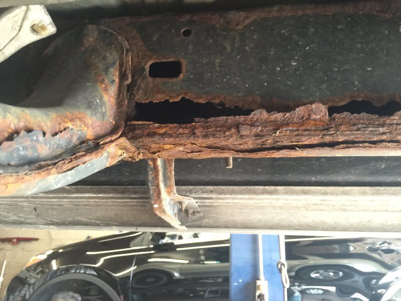

Thanks everyone!
Just one man's opinion, but that frame rail is toast.

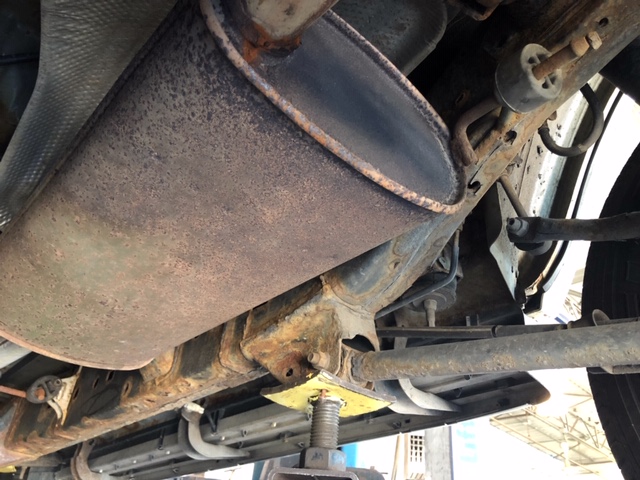

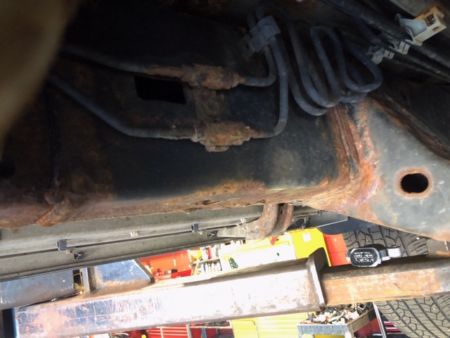

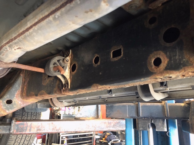

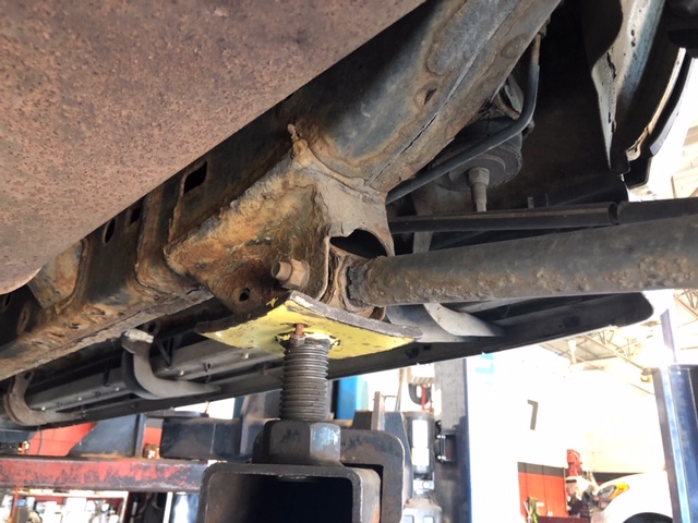

Need help too!
Hey guys, Sorry to hijack the thread but I could use some help too and don't have the option to create a new post. (Just signed up)
I'm looking at buying my first 4Runner and wanted to get your opinion on the amount of rust I saw. Is this too much rust for an 06 V8 Sport with 219k?
Thanks in advance!
Thanks in advance!
That's not bad at all. Hit all the metal underneath with a rust preventer of your choice (mine is Fluid Film) each fall and you should have a lot of life left.

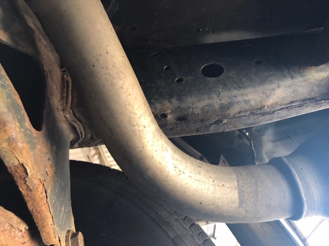

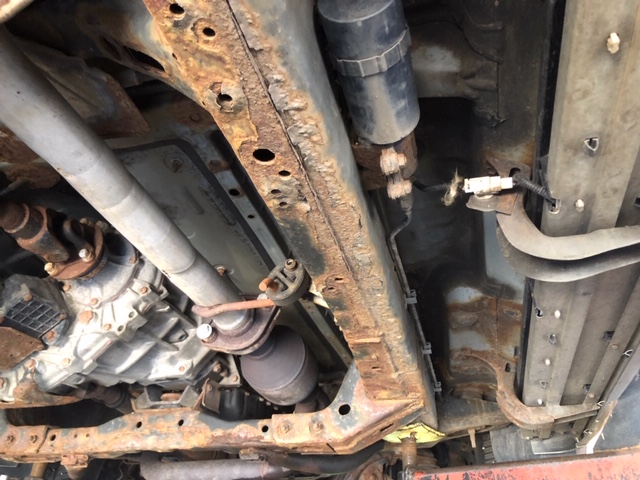

Hey everyone. New guy here. I just bought a 96 4Runner SR5 4wd 5spd @ 130k for $7k. Before buying, I checked the undercarriage for rust and it didn't seem too bad at first and the seller reassured me that it was "just surface rust". Kind of jumped the gun because I've been having a hard time finding a 4wd 5spd with lower miles and there were a few guys checking it out after me...bozo move of me because upon putting it on a lift, I saw the rust was worse than I thought. How bad is this? I'm wondering if I should try sanding it all out, applying something like Corroseal and then Por15, or just try and resell to get my money back...I live in San Diego, CA btw so I'm hopeful that any treated rust wouldn't come back. Any opinions would be greatly appreciated. Thanks.
Sorry to hijack this thread again but I'm really concerned about getting this thing to last another 7 or 8 years...
Take a hammer to the frame and make sure there are no soft spots. Check near the rear passenger wheel carefully. This level of rust is certainly treatable, and so long as there are no holes anywhere, you're fine. I rescued my 99 with POR and annual Fluid Film treatments.
