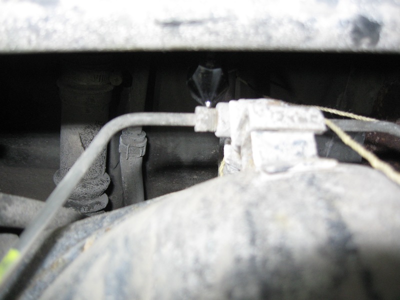

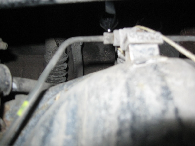

Just wanted to update this in case someone is looking. I just installed 906/5100's on my 96. I used a plumb bob, and also measured numerous locations. I gained exactly two inches of lift 22" hub center to fender and my axle did not move a 1/16th of an inch.
