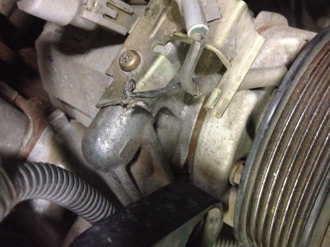

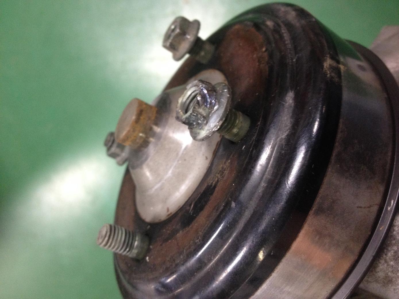

The first thing I ran into was the fan bolts were so tight I had to remove the complete fan pulley support and use heat to remove the nut.
To remove this fan pulley bracket, the plastic cam shaft pulley covers come off, One Bolt Missing. Next the air compressor. One Bolt Missing & Bracket Broken. The bracket holds the compressor into place to help start the top bolt.
After everything was removed I confirmed that the water pump and timing belt are new and shiny!
Then I looked for other signs that dealership mechanic had done his best. I found on the plastic cover around the lower engine pulley was missing a bolt. The last thing I found was the nut located on the top stud of the power steering pump was gone.

Cooling Fan Nut Over Tightened
Cam Cover Bolt Missing
Air Compressor Bolt Missing & Bracket Broken
Lower Cover Bolt Missing
Power Steering Pump Nut Missing
