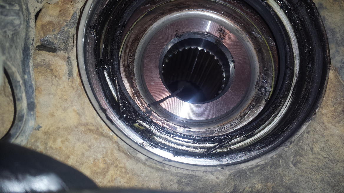

I'm replacing my inner boot on cv axle driver side.
its already 1 am so tomorrow morning I'll go get a new inner boot ,clamps and grease. Also I have noticed that this seal on the picture it's ripped off . I have no idea how they call this part. Need help Guys :)

Is that the seal in the front diff--driver side? I think it is 90311-47012.
Or is it the seal in the steering knuckle? I've been looking for the part number for the seal in the knuckle--and whether it can be replaced without removing the bearing and hub from the knuckle. A spring like that fell out when I removed my CV.
Oh yea, I used Lucas Gear Lube 85W-140 at the recommendation of East Coast Gear Supply. It's heavier that what Toyota recommends, but in the end I don't think it makes a difference if you go factory or a little heavier.

Your seal can be r/r with bearing bolted on.
I don't think that's the differential seal. It looks like the spindle and bearing in the photo. I don't know the part number but it's the dust shield that keeps debris out of the bearing. Any decent auto parts store will be able to get one.
I got that part from partsource here in edmonton.
Was 17$ . Already installed on my car :)
Thanks for a help to everyone
