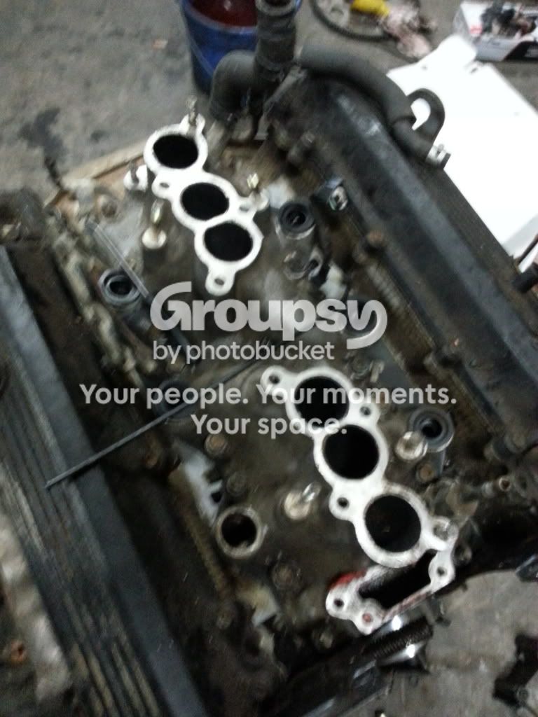

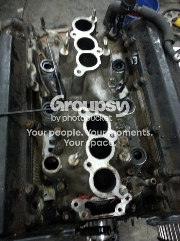

Sounds to like its the water bypass outlet because I fixed a blown head gasket on my 95 and the outlet is in the location you described plus it does have a gasket also. And to get to that is to take your intake off. Then looked straight in the back towards the wall and it will be a little bit downwards.

Here is pics I took.
20121020_153507.jpg~original
20121020_153513.jpg~original
20121020_153524.jpg~original

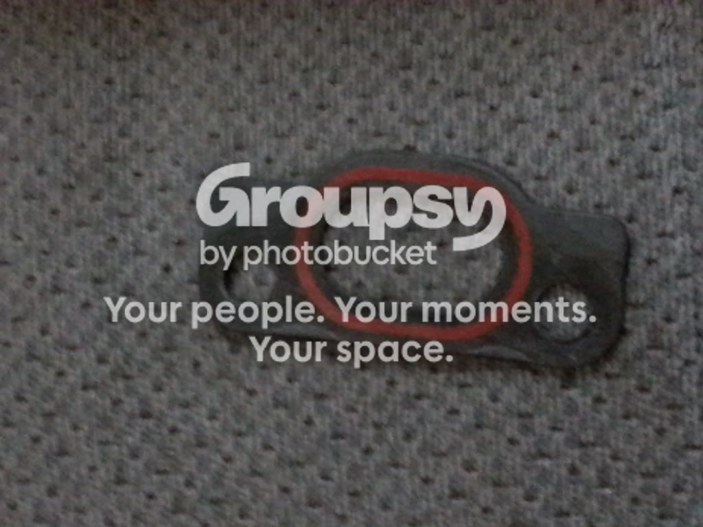

Heres pic of the seal.
20121020_222522.jpg~original
it would have been nice to have that seal when I did mine. my replacement engine had every single sensor back there broken off. of course, the damn thing had a gasket I didn't think to get. I was mad at it, so I cleaned it up and used some rtv silicone. it does not leak.talk about luck.
