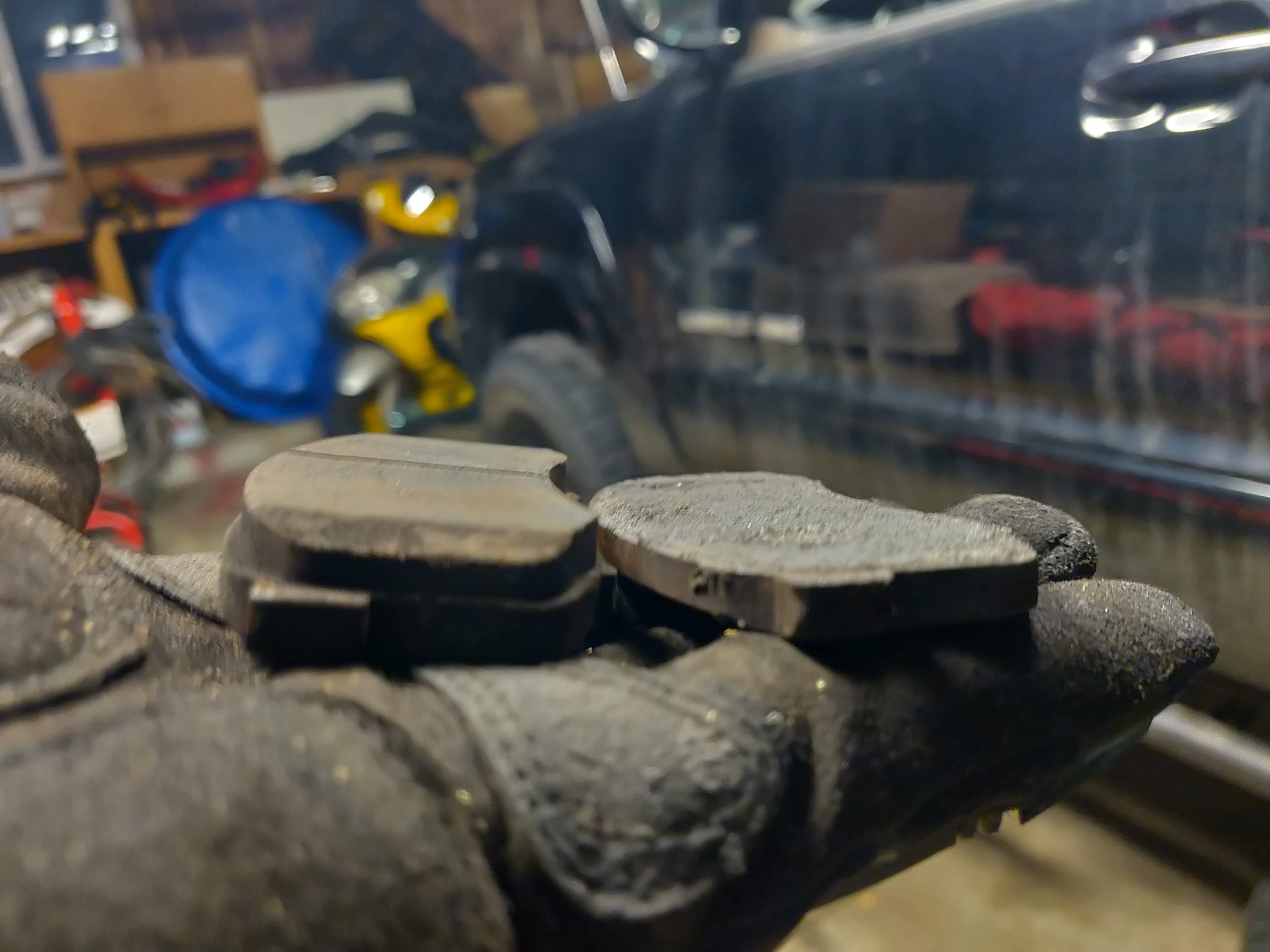

I am legitimately trying to remember if I've ever worn out a set of pads through normal use. I think all mine have been replaced along with a seized caliper.
Pad on the right was from a seized caliper. The rest looked like the left side. Only drove it like one day to look like that [emoji28]
