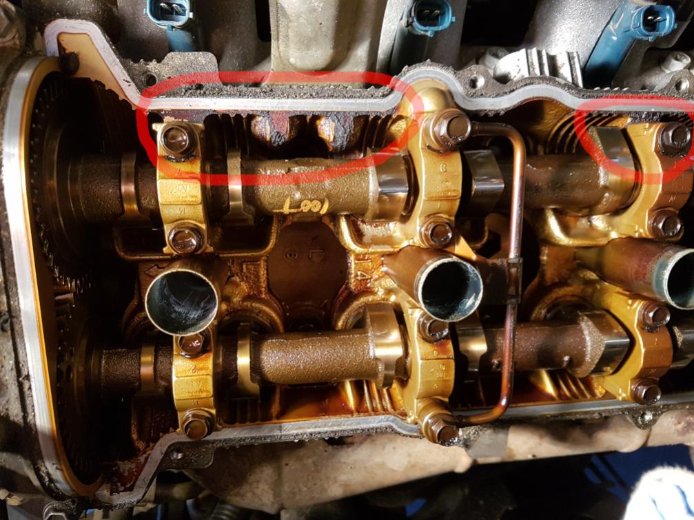

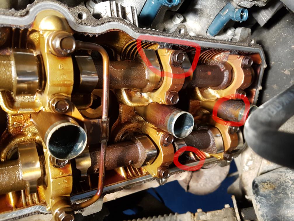

While replacing my valve cover gaskets (2003 V8 2UZ-FE), I found sand/dust/mud inside the valve compartment. I'm guessing the gasket must have been too worn out while I was driving in high-dust roads and the engine vacuum sucked it in.
Question: What to do? Some ideas I have:
  • It's the kiss of death, sell it
  • Change the oil frequently for the next year or so
  • That sand needs to come out, camshafts need to be removed and cleaned
The other side is clean.

Run your fingernail on the surface of the cam lobes. Do you feel ridges, major or minor ones? Can you see signs of damage? Have you drained your oil and noticed debris? Oil analysis that shows increase of metals as a result of damage from foreign matter? Do you have a borescope (cheapo usb connected ones on amazon) to look at cylinder walls, bearings, etc?
You can likely take care of the majority of the sand in the cam tray without removing the cams. The pictures are not high res enough for me to see any issues on the cam lobes, they dont have a streak but I also cannot say that for sure.
Thank you [MENTION=616820]triethylborane[/MENTION]!
To answer your questions:
  • Here is a link to high-res pictures: https://www.hectorh.ca/4runner/valves/
  • Fingernail test: feels smooth like glass, however the lobes on this side have a dull appearance when compared with the other side which is shiny like a mirror
  • Other than the dull surface, some of the cam lobes show oil staining. Is this a sign of excessive valve clearance? See https://www.hectorh.ca/4runner/valves/20210608_213641.jpg for an example. That stain is embedded in the metal, rubbing with a paper towel does not clean it off.
  • I do have a borescope, is it worth removing the spark plugs to check the cylinder walls?
  • I have not changed the oil yet and the last time I did an oil change (8 months ago, after dirt road season was over), I did not notice any debris in the oil
  • No, I have not had the oil tested. Is it a good idea to do so in this situation?

Ok, thanks for the pics . . . the fingernail test or even using your finger is a good litmus test to determine whether a cam lobe has wear beyond specs. Smooth like glass passes litmus test, though test all lobes.
A dull cam lobe is fine here because the major issue with debris is streaking on the lobe. Not uncommon to have one cam flank (closing/opening) differ in visual appearance from the other with various factors, I would not be overly concerned about it as long as the cam does not have any visual streaks and passes finger test.
Excessive or out of spec clearances between the valvetrain and camshaft can manifest in oil stains, though a quality engine oil with additives usually help with the oil stains. Its a varnish at this point and not much of a concern IMHO. Best bet is to use a high quality engine oil (synthetic as you are using) and shorter oil change interval . . . 5-6k mi maybe. Its what I tend to do on my 4R.
If you are thinking of selling your rig over this issue, then maybe piece of mind might be worth the trouble in pulling a coil and plug to borescope a cylinder. At this point if you didnt feel any issues with the cam lobes, the oil probably did its job and put particles in suspension and into the bottom of the oil pan.
I normally do an oil change on conditions, mileage or time, but given you are concerned with debris, might be worthwhile to drop the oil and collect some of it to send to an oil analysis lab like Blackstone. Not expensive, but if you didnt see debris 8mo ago and if you do one now without seeing any debris then maybe you just had debris build up at the inner edge of the valve cover flange.
Bottom line oil changes are cheap, oil analysis is cheap, borescoping a few spots takes half an hour at most, but a new rig usually not the cheapest. My assessment anyway.

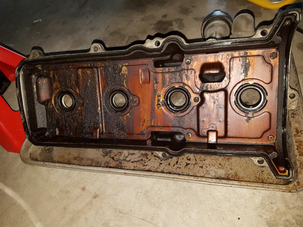

[MENTION=146398]hectorh[/MENTION]
Looks a little like sludging. Put some in a metal container and see if it completely dissolves with a good cleaner, like brake clean.
Drop the small metal oil pan and look for stuff in the pan and the oil pick up. Also remove the front cam caps and clean the filter screen. If the sucker gets restricted it will seize the cam. Look at a part diagram to find exactly where it’s located.
