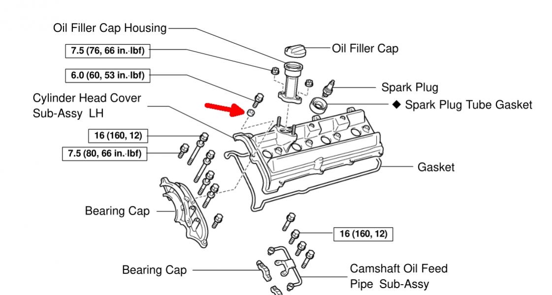

Not sure exactly which one you are asking for. I am guessing this one?
Toyota PN 9020110133
Not that one. The one you indicated is a metal washer for the cylinder head bolts.
But thank you because I did not know about partsouq.com. It's now in my bookmarks. :thumb:
The one I'm looking for (from FSM 14-19, page 1570):
Look at 11201B
CYLINDER HEAD. Toyota | Toyota
9021006013 - Washer. Seal(for cylinder head cover); seal(for cylinder head cover, left) - Genuine Toyota Part
Looks integrated, but superseded pns show the seal washer
9021006008 - Washer, seal(for cylinder head cover). Interchangeable with 9021006013 - Genuine Toyota Part
https://www.autohausaz.com/pn/9021006008
[MENTION=146398]hectorh[/MENTION]

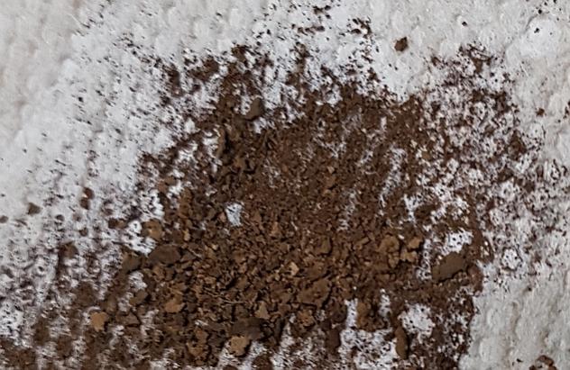

Looks a little like sludging. Put some in a metal container and see if it completely dissolves with a good cleaner, like brake clean.
This is what the black stuff looks like once I stir it with brake clean. I think it's definitively dirt and not sludge
attachment.php
:ohwell:
I was cleaning the dirty cover when I noticed that one of the corners is lifted higher. This is also the area where the worst damage is located.

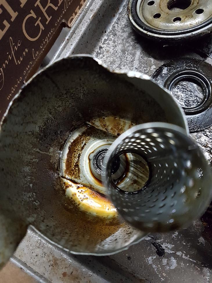

I happened to find my oil filter from last year's oil change, opened it and look at what I found inside
attachment.php
I'm going to be opening every oil filter from now on. This issue has been going on for over a year. Before that, all maintenance was done at the dealership.
Now I have to figure out how to remove the oil pan with the front axle in the way.

The bolt and washer are included in the purchase of the bolt. I just recently purchased #90080-10330 and the washer was included. Purchased from McGeorge online
90080-10330 X 18
11214-50011 X 1
11213-50031 X 1
11193-50010 X 8
Should be the necessary part list post 2007 2UZFE

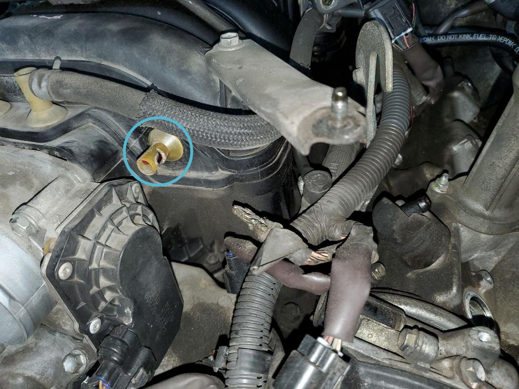

I was working on removing the driver side valve cover and had a hard time removing the hose that connects to the PCV valve. While I managed to disconnect the hose, I broke the plastic 90 degree elbow that comes out of the intake manifold.
I searched around and was unable to find the name of the part or a part number to replace it. Does anyone know what it is?
