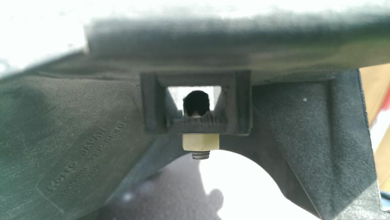

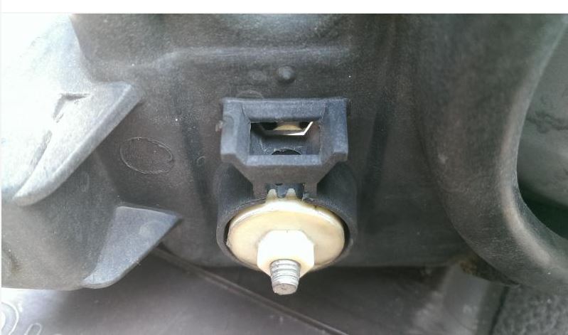

I just replaced the driver side and here's what the back side of the headlight assembly looks like. You can see there are slots for a screwdriver or tool that allows you to get to the plastic teeth. Hope this helps.

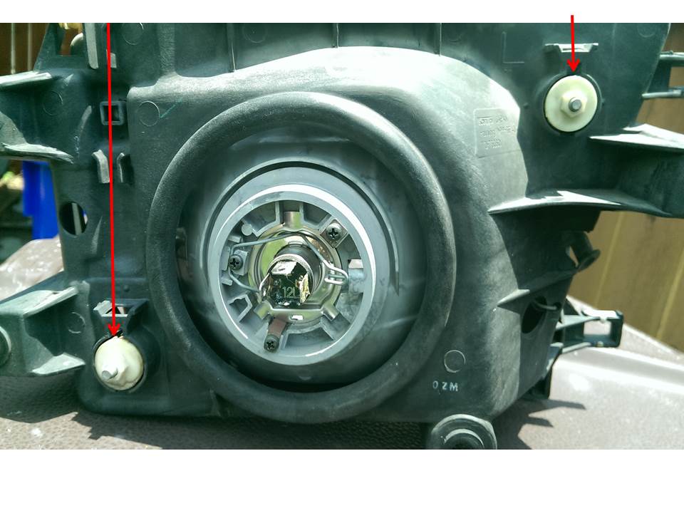

So I am trying to raise my passenger side beam and when I loosen the white plastic nut with the teeth it just backs off the bolt and creates play. My light can then be pushed up where I want it but it will not stay in place????
What am I missing?

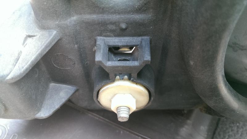

The problem I'm having is that I turn the nuts and nothing happens with the adjustments. Should I assume they are stripped and I need new housings? Thanks,
Jim
When I got my truck, the threaded metal rods that are turned by the white nuts/plastic gear had been somehow backed out of their threaded holes in the front of the assembly. Check that they are correctly threaded into the plastic and not dangling loose.
