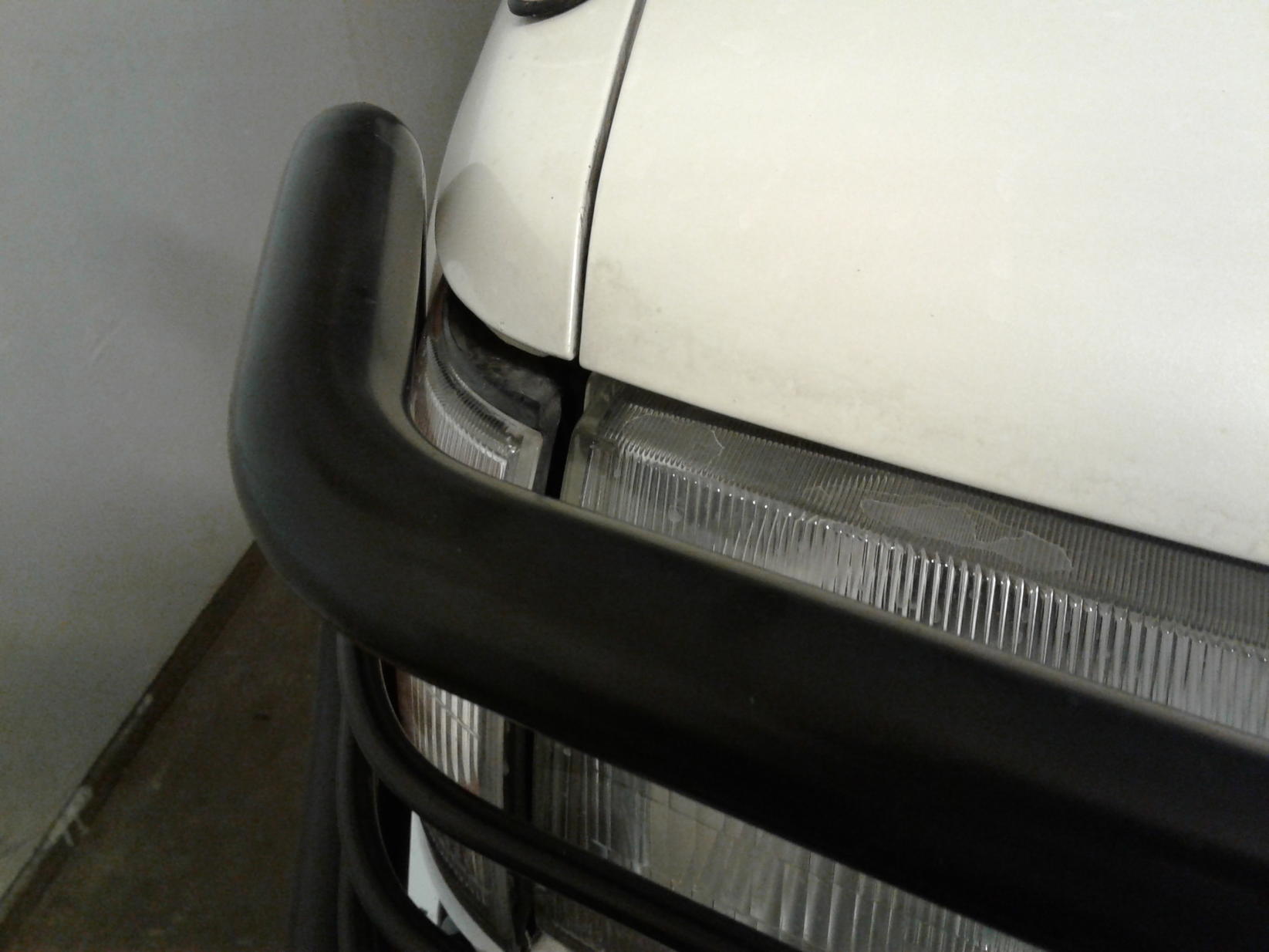

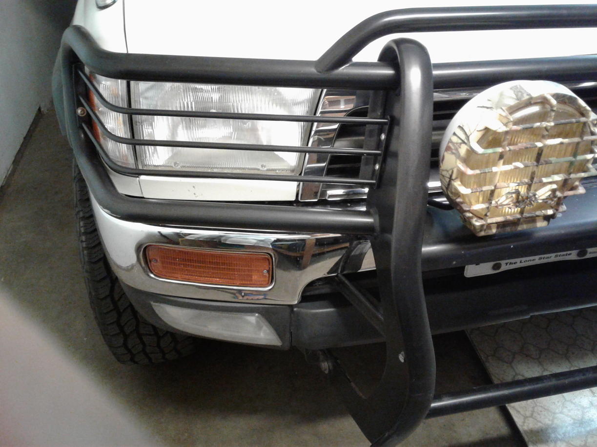

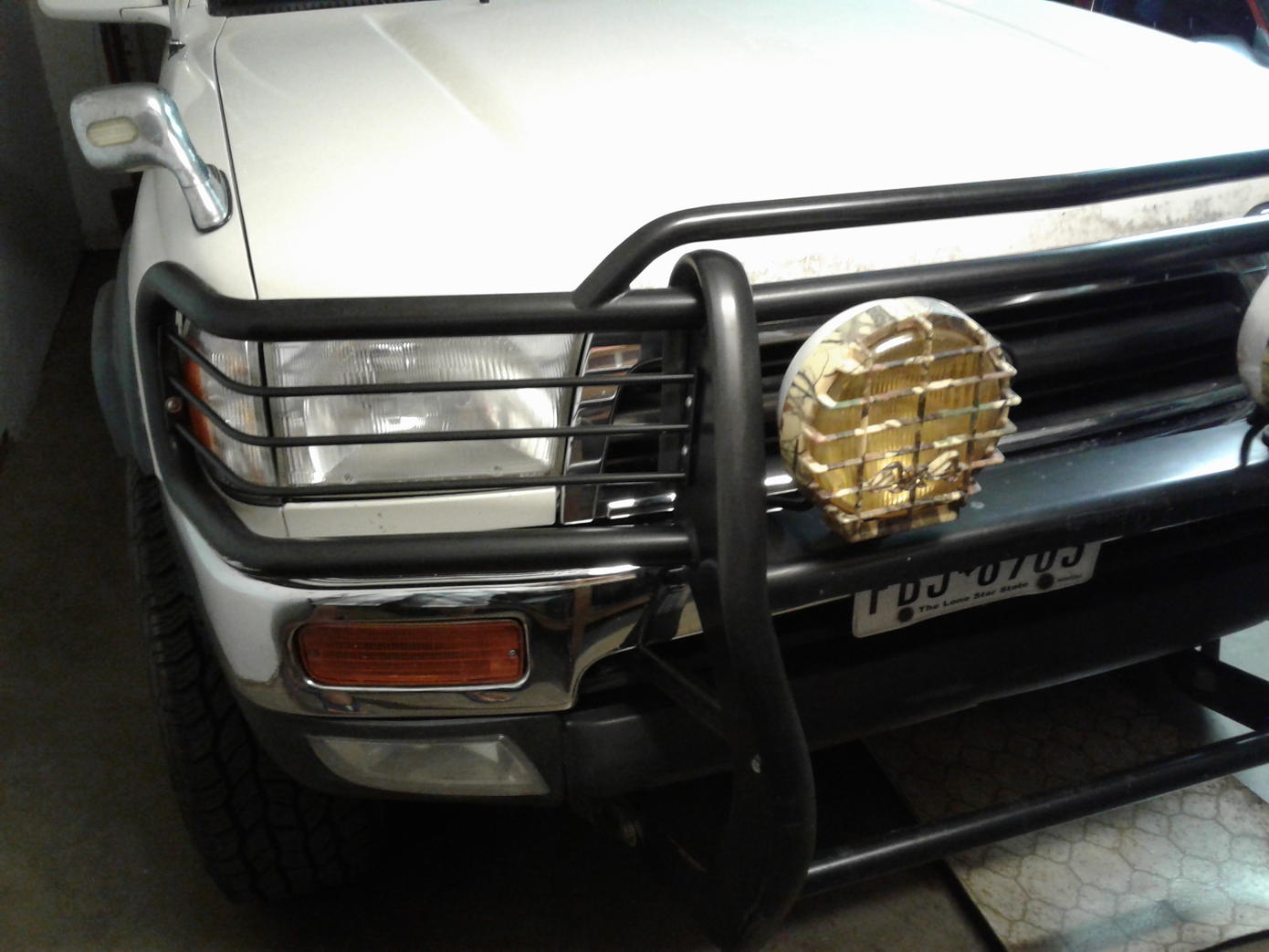

The truck was parked when this happened. A SOB hit and ran and from the look of it, a car, minivan or an suv with a plastic bumper hit the grill guard from the passenger side causing the grill guard to push towards the driver side.
The loop on the passenger side then hit the side marker light breaking both tabs it got to attach to the headlamp assembly.
Should I pull the grill guard with one of those cable pullers to get it back to normal?

Probably wont take much to bend it back and using a come along attached to something big and heavy. The other option would be to undo the bolts holding it on and either scrap it or sell it and buy a good steel aftermarket bumper or leave it alone with the clean stock look.
Also think that it wouldn't take much to pull it back to at least close to where it was originally. Good example of why people often refer to those as damage multipliers. Because they don't really offer any protection and many times end up doing more damage to the vehicle than what would have happened without them.
I'm sure you have reasons to have it, they don't call it a brush guard for nothing. Good for people who really live out in the sticks.
If you try and bend it back, just know the metal is very weak and another hit on that side will bend it even worse the second time.

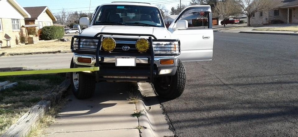

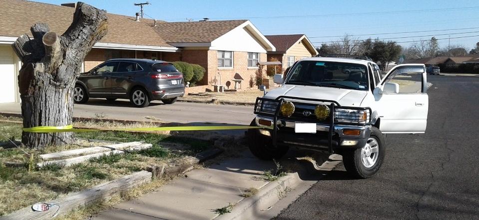

Well... I didn't file a claim. My agent first asked me to check with a local body shop and inform the price to fix it and then they will inform me whether it is worth to file a claim or not.
I am a person who loves to do things with my hand because I know I get it right.... so yes.. I was doing the followings on a dead tree (again, which I took down a little at a time with the help of my wife). It was s success. There is a slight twist on the vertical part of the grill guard but overall I am satisfied. Also, fabricated the broken tabs on the side marker light.
Had the truck in 4Lo during this operation.
My neighbor asked me whether I am trying to remove the tree stump!
Thank you all for your ideas and suggestions.
PS: Any ideas on how to remove the tree stump? :hatsoff:
