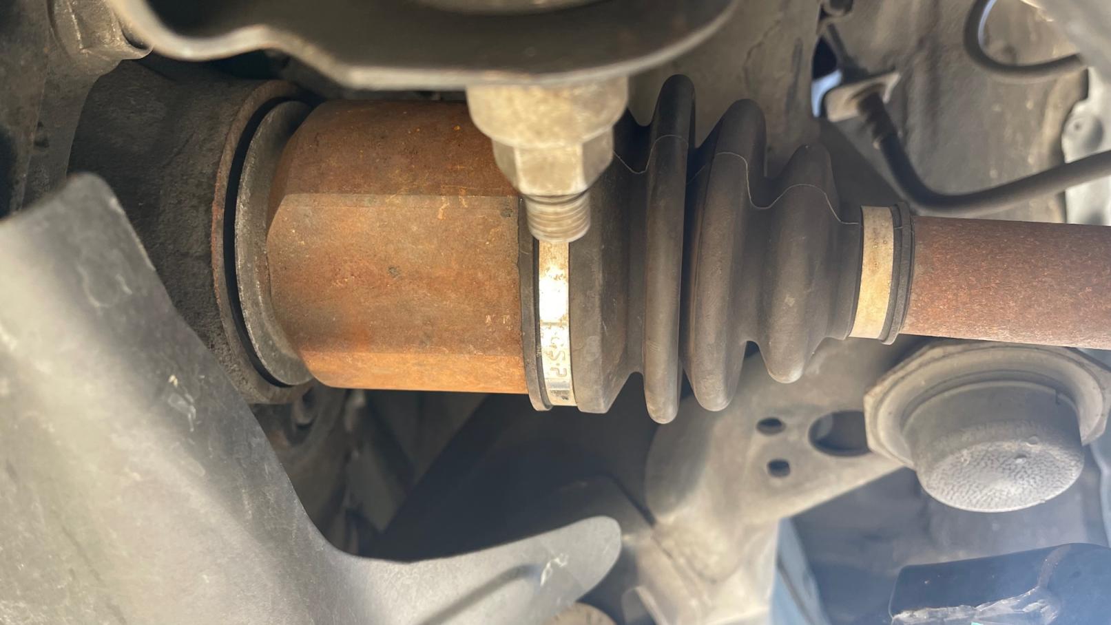

Getting ready to do the CV boots on our 2005 4Runner and need help figuring out if it has aftermarket axles or not.
I was told the 5th Gen CV boot kits are interchangeable with the 4th gen.
My 16' 5th gen has 11-1/2" diameter (OD) inner axle cup and the 4th gen is 10-1/2" diameter (OD) and the 4th generation does not the cutouts to use a chisel on to remove them.
Do these look OEM?

It doesn't look OEM because it doesn't have the turned notches for the removal/installation tool and the boot clamp says "GSP".
