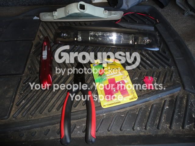

start with the hardware and tools. this is all you need

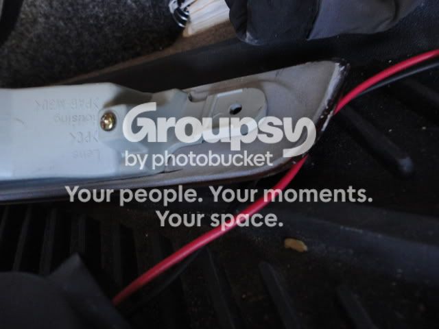

now a lot of guys i guess have removed this weather stripping from the old light and put it on the new one and i think this would be fine if you have the red lens but i dont so i didn't

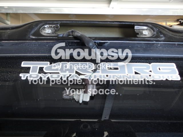

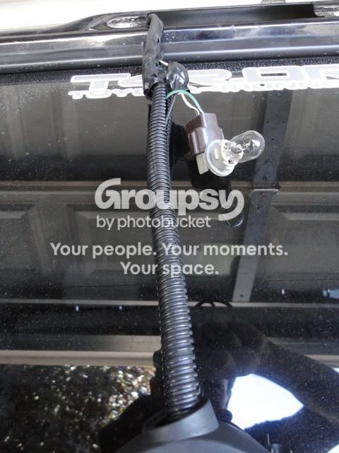

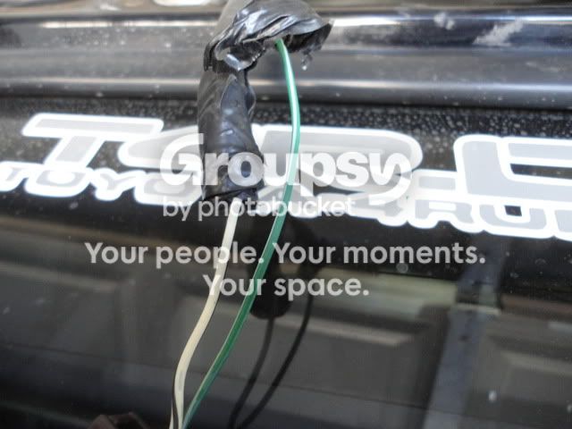

next unscrew your light and twist the bulb socket out of the old housing, cut the tape back so you have accses to the wires NOTE: the green wire is the power and the white and black is the ground

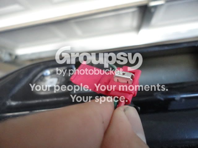

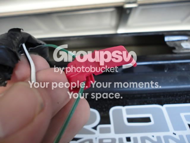

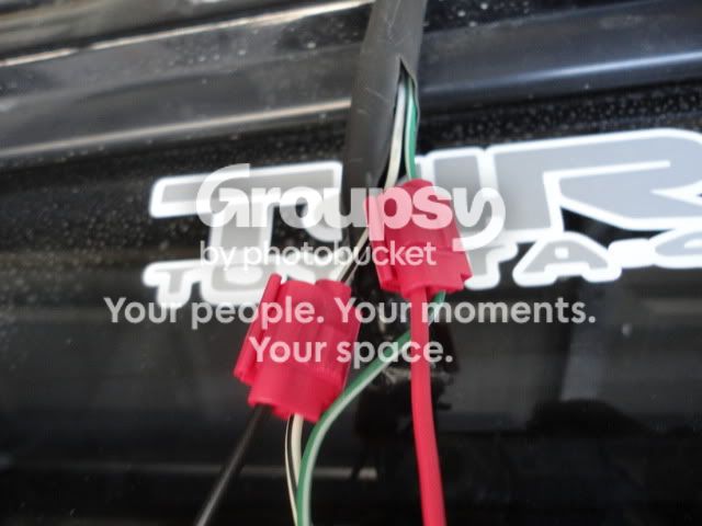

next get your taps, crimpers what ever you want to call it and put the green wire in first to the slot, isnert the red wire from the new light in the other hole
008-7.jpg~original
010-6.jpg~original
do the same thing to both wires
011-3.jpg~original
tape it up or use this plastic stuff like i did with the wires

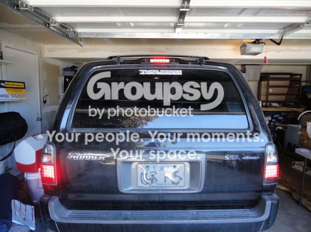

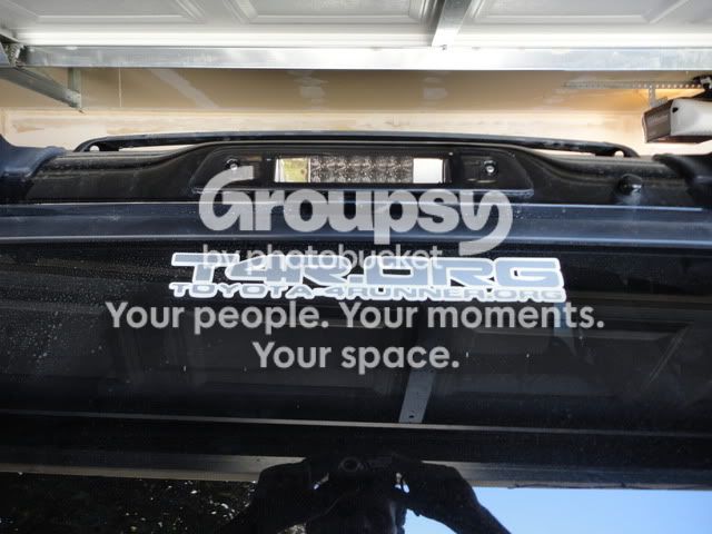

and PRESTO!

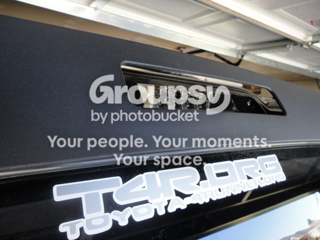

thanks man! and no worries i think this is a great mod! the light is super bright. im not sure i like the smoke as much as i thought but then again my truck is dirty so maybe after i wash it we'll be good
