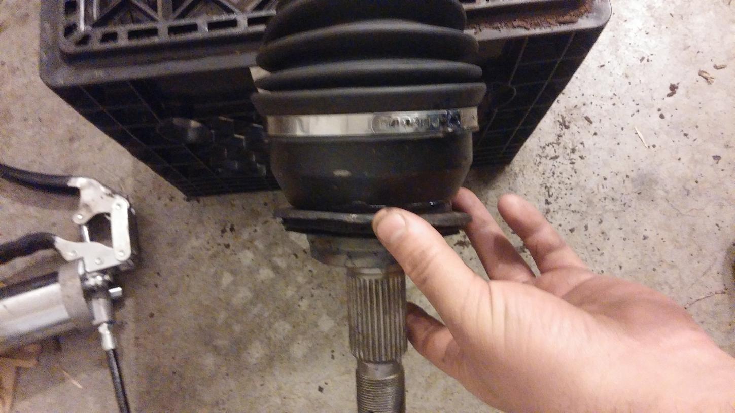

I did the stainless steel hose clamps on mine. With the boot pulled down the shaft, no issues with the clamp hitting the boot.
You can use cv boot clamps from auto parts stores
West marine might have some thin ss hose clamps
Or in a pinch i used some harbor freight clamps that were thin
But a member gave me some mascaster carr ss hose clamps
I ordered the McMaster stainless smooth clamps, should be here by Friday, or so they said when I called. Can I do the mod with the axles in place or will I have to pull them out to do it?
You do it right in place
Just the 2 outer ones
Remove old clamp
Slide boot back bot to far just so the fins don't rub at normal ride height
Then make sure the shaft is dry and clean
Some people use a dab of gasket sealant - i do not
And tighten new clamp and done
Dont over tighten the clamp
You should be good to go
Every now and then check them to see if they slipped back at al

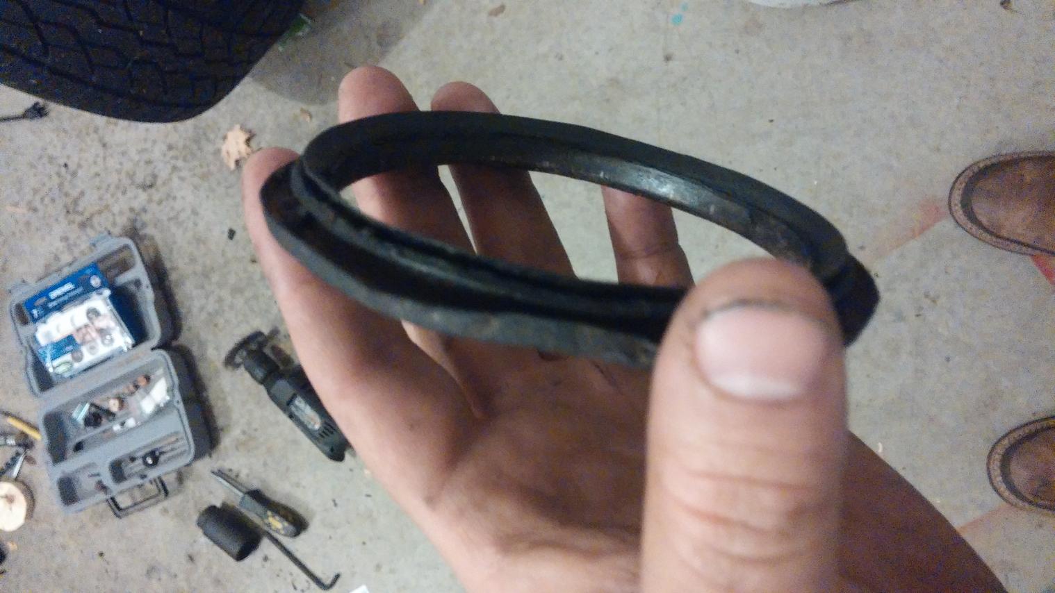

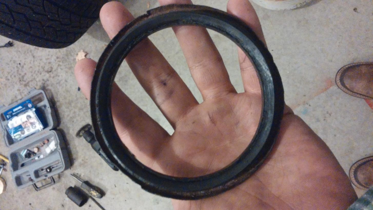

I'm hoping that you guys can help me here. When I pulled my CV axle, there was a seal on the wheel side (farthest away from the differential. I bought a rebuilt Cardone shaft that didn't come with that same seal. In the past, with my Tacoma, I just tapped the old seal off and put it on the new shaft. In this case it's too torn up to reuse and I can't find the part number to save my life.
On this truck, there is a seal on the inboard side of the wheel hub that protects the bearing from dust. That stayed in place. It's still in the hub. The seal that I'm talking about appears to be referred to as a knuckle hub in earlier posts in this thread. It rides on the outboard side of the CV shaft and meshes with the wheel dust seal. Basically it looks like the one seal on the axle mates with one seal in the wheel hub.
In the video posted a few posts back I can clearly see the same seal on the shaft the guy removes and there appears to be one on the axle that he puts back in.
I'll post pictures below. Am I right that there is a seal that mounts on the wheel-side of the axle that mates with the seal on the inside of the wheel hub? I have a Timken 710573 seal that is mentioned a few posts back. It looks like it would mount cleanly into the wheel hub and once you crank down on the axle nut it would seat on the axle as well thus replacing two seals with one. Am I wrong there?
Attached are pictures of the seal that I took off of the old shaft and can't find a replacement for to put on the new shaft. The last picture is showing where the seal was on the old axle and how it was oriented.

There is a lip on the cv axle end that fits nicely into the hub inner seal on the knuckle as you described. My re-maned axles already had them on so I didn't need to swap them over or replace. However, Cranking down on the axle nut it will NOT seat the NEW Timken inner seal on the backside of the hub if you replace it - I tried that this weekend. You have to somehow "press" or use even-force to get that seal to seat in the back of the hub/knuckle. We fab'd up a make shift piece of wood that fit inside the seal, hit in the middle with a hammer and the seal went in FLUSH with the backside of the hub. I read some people use a 2" pvc pipe and have seen some fab up a piece of metal to hit with a hammer to seat that seal - it has to be somewhat even pressure. Here is our make shift tool created @ about 2am:
Make sure you thoroughly clean any crud/rust/debris from any of the surfaces you are putting the new inner seal on. I used a scotch-brite to clean the backside of the knuckle and marine grease to help the install the new inner seal. Only time will tell if that seal was seated correctly though - fingers crossed. One piece to call out - make sure you re install the dust shield BEFORE putting the new hub and bearing in place. We got all the way through on one side, only to see the dust shield sitting under the car, staring at us like idiots. Silly mistake but an easy one if you're working late and getting tired. I hope this helps.

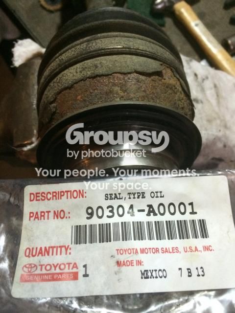

I just wrapped up installing the new CVJ axles and I wanted to update this thread with something interesting I found during the install. I didn't have a jig to set the new knuckle seals but while I was looking for something to use I noticed the grease cap that covers the axle nut is actually a PERFECT fit for the knuckle seals. It worked perfect for seating the new seals.
That certainly looks like the right one. Thanks.
