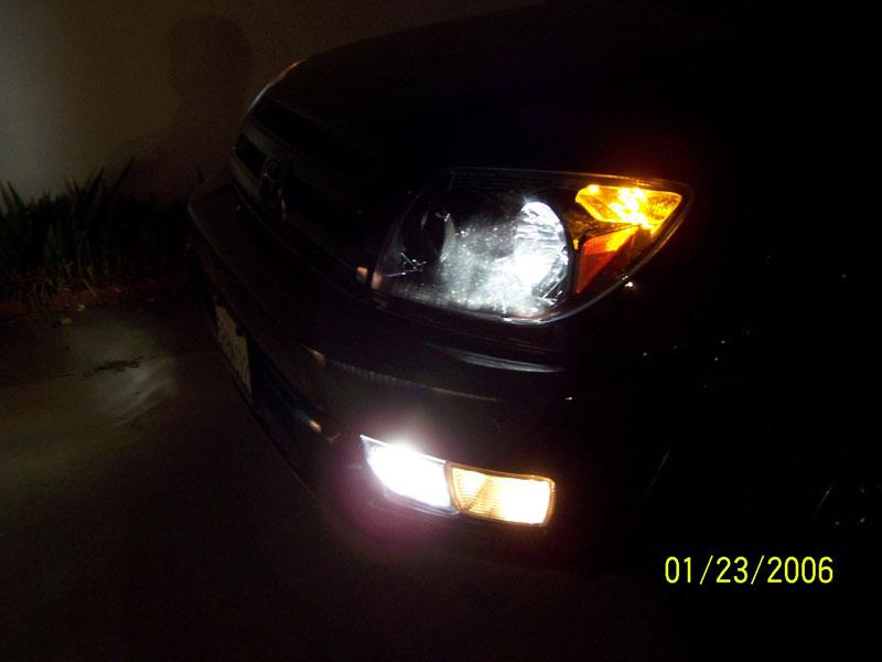

it just for fun. i just want the front corner bumper light to be ON at night. so at night all the front light are ON (fog, corner bumper light, headlight).

i think i know how.
since DRL only use 1 of 2 fillament for DRL/Signal, maybe i can use the other fillament (i don't think it's used for anything because there's only 2 wires + -) and connect it to the parking light (the one on the headlight). So at night, i can have that light up and still have my Signal. At day time, it's just gonna be a DRL/Signal

YSutarko said:
i think i know how.
let me know if i'm wrong
thanks
You're not wrong. That is how I did it. Inserted a terminal for the unused pin on the socket and wired it to the live wire on the small parking light. PITA for some of the connections but all the wires are there to work with.

at night w/o turn signal
since DRL only use 1 of 2 fillament for DRL/Signal, i can used the other fillament (it's not used for anything because there's only 2 wires + -) and connect it to the parking light (the one on the headlight).
